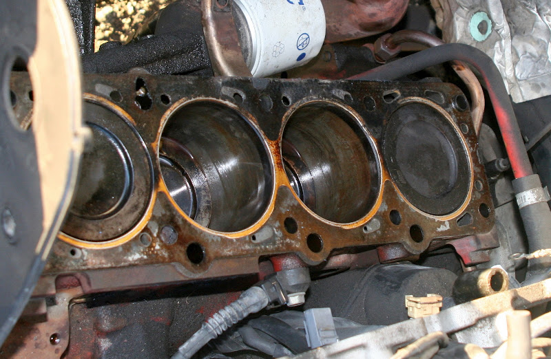

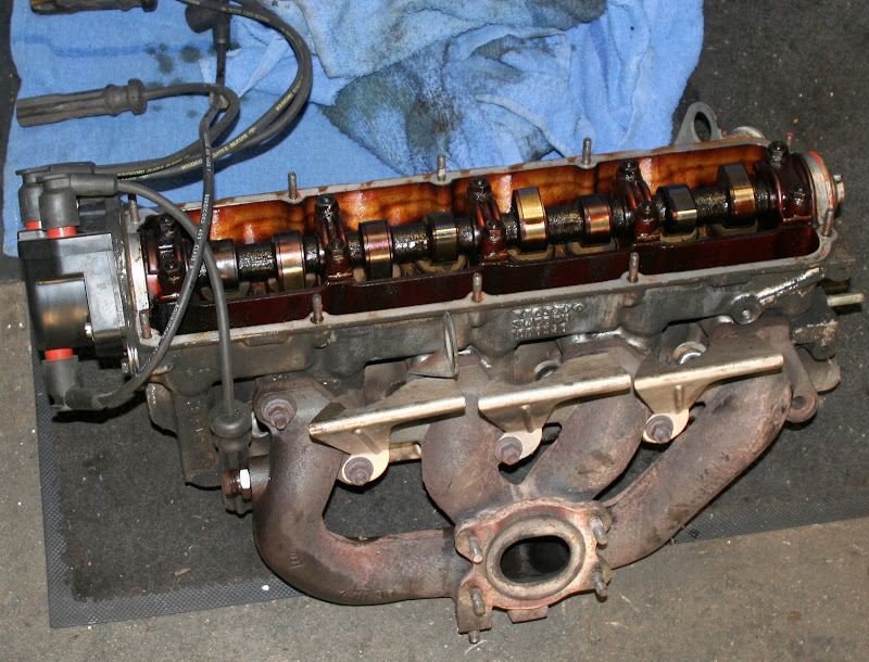

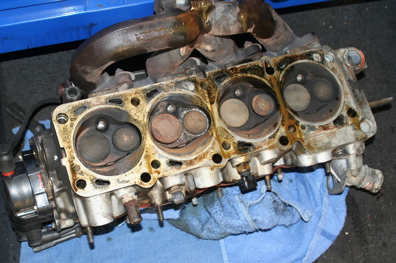

my mechanic took the head off today.
#2 and #3 were sucking coolant from the blown head gasket.
the head had several hairline cracks, looked old. I was offered a good head for a good price, its en route, should be running next week.
