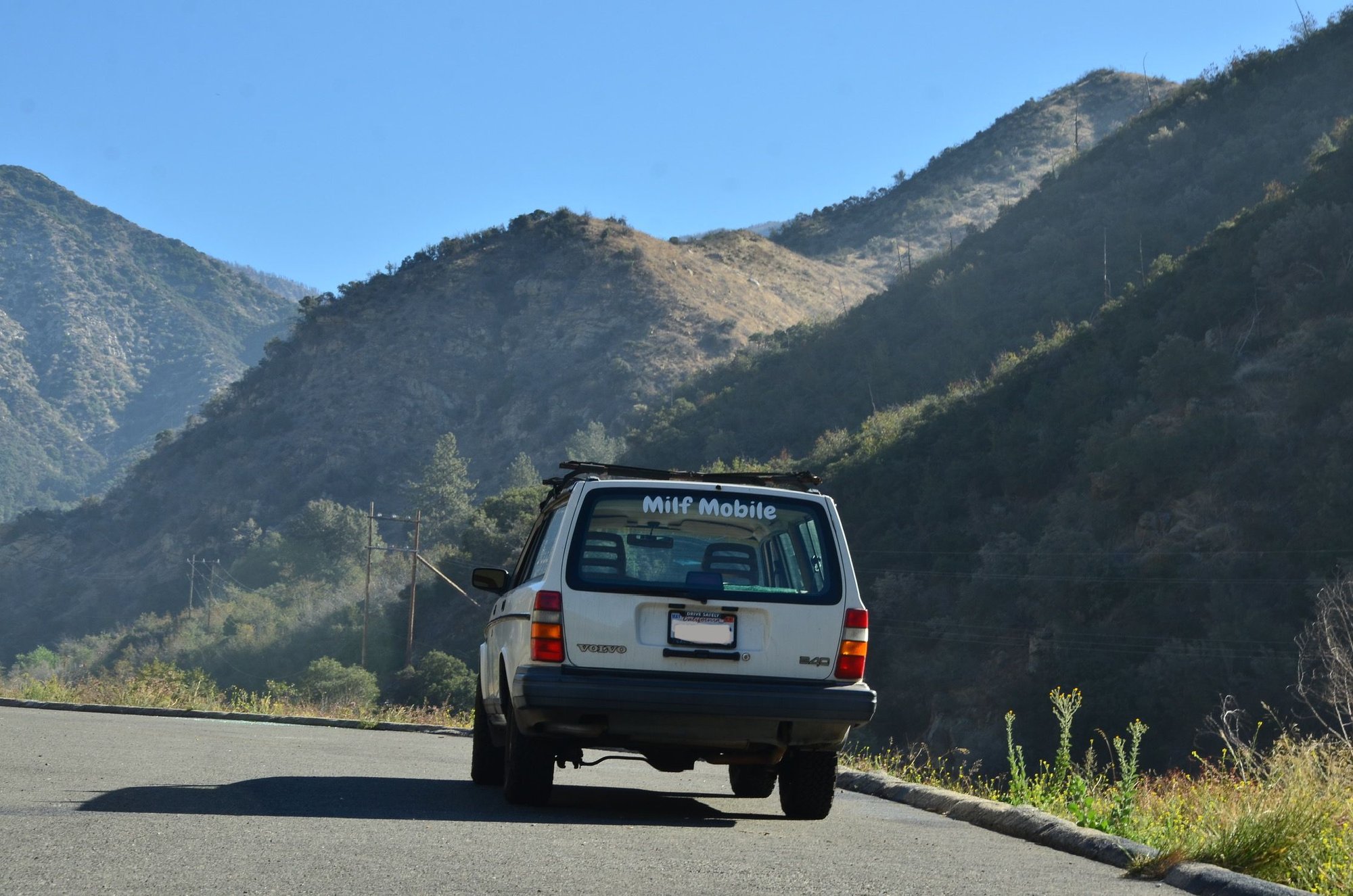

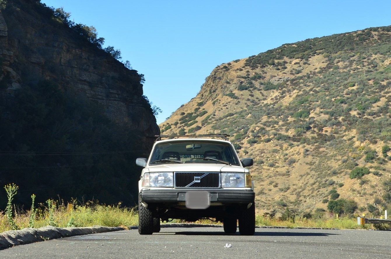

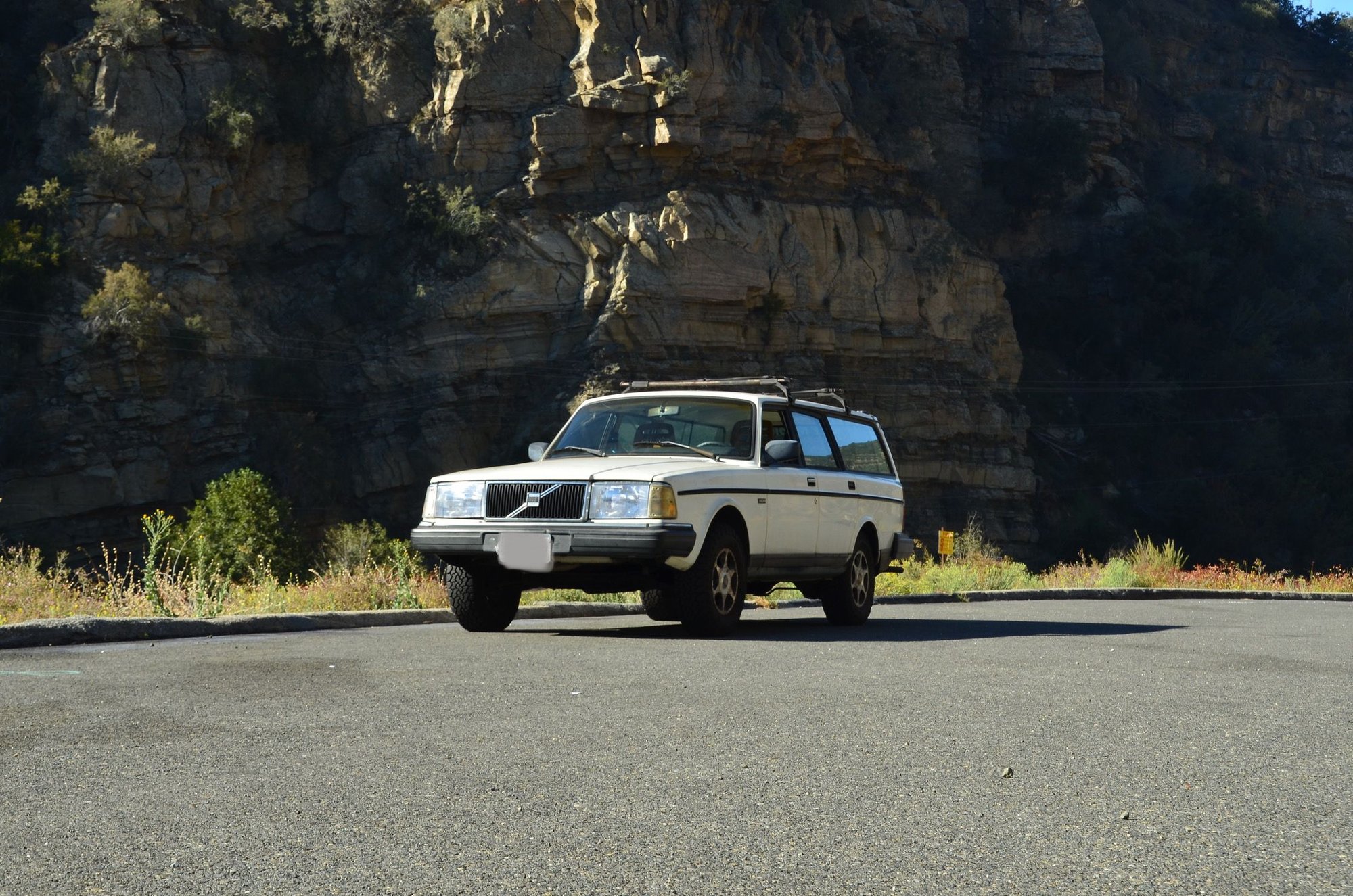

A bit of a necro post..., but I've been rockin' a lifted '92 wagon since around when you originally posted this. Despite only being 2wd, they're mighty fun in the mountains and the desert! I took these pictures recently on my way home from some mountain fun.
