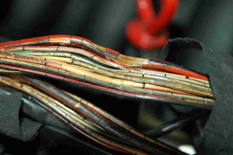

also, 1985 is in the midst of the 'ecojunk' aka 'biodegradable' wiring era for Volvo (from about 1982 to mid year 1987, some folks say as early as 1980). The engine harnesses on those years is very prone to crumbling and failing insulation, this is often NOT evident as it happens inside the outer black sheaths where it can't be seen.

I did also hear about the "biodegradable" wiring harness, but the insulation was very good when I looked at it. No (visible) cracks, and the wires aren't stiff or hard to move, they feel fine to me, and with the general condition of the car I'm thinking someone might have replaced them in the past or just got lucky and they didn't degrade as fast.
