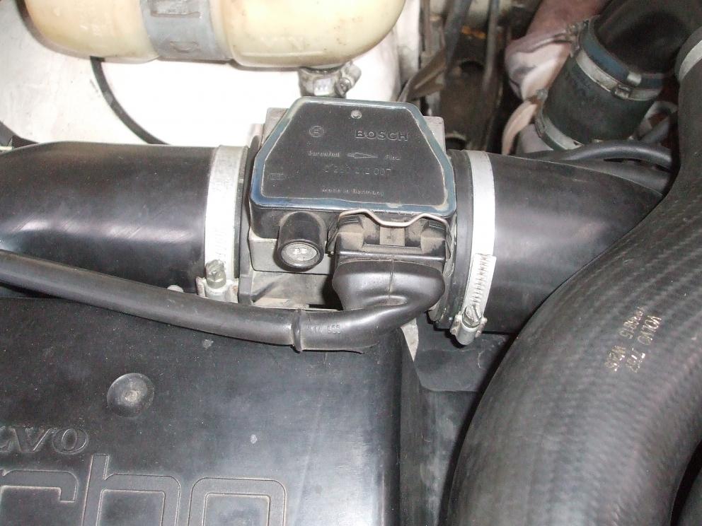

I actually thought that N/A cars had LH2.4 starting in 1988. The distributor in LH2.4 cars can move just the same as on LH2.2. The distributor casting is the same, the sensor (an plug) are not on the bottom of the LH2.4, and moving it just really doesn't change anything. So pictures will explain better:

The quickest way I tell an LH2.2 car from an LH2.4 car is the mass airflow sensor. Here is a picture of my LH2.2 sensor:
The thing to look at it the plastic cylinder just to the right of the connector. There is an adjustment screw hidden in there on and LH2.2 car. LH2.4 does not have that screw, so the cylinder is not there. It's just a flat space next to the connector. So if the cylinder is there, you have LH2.2. If it's not, it's LH2.4.
Okay I just found my LH2.4 mass airflow sensor, so now you can see the difference:

the LH2.2 has MAF with a bosch number that ends in 007, while LH2.4 ends in 016
also, the LH2.4 cars have the diagnostic box on the left strut tower, while the LH2.2 don't.
