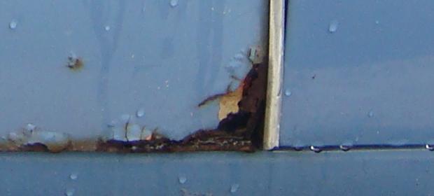

How bad can the door rust be to the cars health?
This particular rust is right under the driver's door on a '90 245 wagon...
I am thinking of buying this car, but what should I do to fix the rust? A new coat of paint? Add a steel plate behind it...?

I'd change the whole door. If you are near one of those Pick Your Part places, older Volvos are plentyful and the price is like $30. Or any jukyard for older cars.
But I wonder how much more rust there is in other places. Remember rust is like an iceberg-90% is hidden from view.
+1 on that.... There's a reason why some call rust "Cancer"...... Old VWs' are notorious for that, as are some old Volvos. I would look over the car thoroughly and see where else it has spread, that way you know what you are getting into! If it's just the door,you could weld a new piece, grint the rust and use body filler AKA bondo, but why go thru all that labor when you can just swap out a door skin/frame for close to nothing like tedv metioned. IMO, that is the way to go, it's super easy and simple fix too! Being the fanatic I am, when I wax my cars, I wax the door sills, jambs, interior door skins and interior trunk lid.It's a super clean 850 but it's a PITA, but I want to make sure that at least those seams at least have some sort of protection inhibiting rust. Good luck on your project. Sounds like a fun one!
