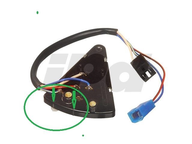

The red female connector does send power to the starter (not ground like you tried) but the neutral starting switch has to be connected and working.
The neutral switch can become disconnected from the shifter. Undo the two screws holding the shift cover down and verify the white pointer is lined up with the 2 marks areas on the top of the Neutral starting switch circled in green, 1 mark lines up in park and the other is for neutral.
Thank you.
Suggestions accomplished. Neutral safety with is attached to the shifter and is in the proper position. I sprayed some contact cleaner on it.
