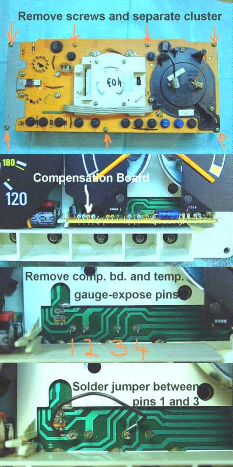

My next move was to try and utilize the stock sensor for the Auto Meter gauge. I'm not an electrician, so that didn't go well.
After reading more threads about the compensation board bypass, I kick my self now for not doing more research earlier on the subject. My temp needle goes just past the bottom line in on the stock gauge,...and that's it, under ANY driving conditions.
I'm going to jump #1 and #3 and see if that helps it.
I leave the compensation board out,...correct? Sorry for sounding stupid, but nobody has specified that.

Yes, you leave the comp board out after you do the bypass. The single wire temp sender is for the guage. The other sensor which is harder to get at, under runner #3, is for the fuel and ignition ECU.

Dang bill, all that work and I was replacing the wrong sensor...
Thanks for clearing it up!!!
So, could I just use the stock gauge sensor to connect to an aftermarket temp gauge? If that is the case,....it should be pretty simple.
