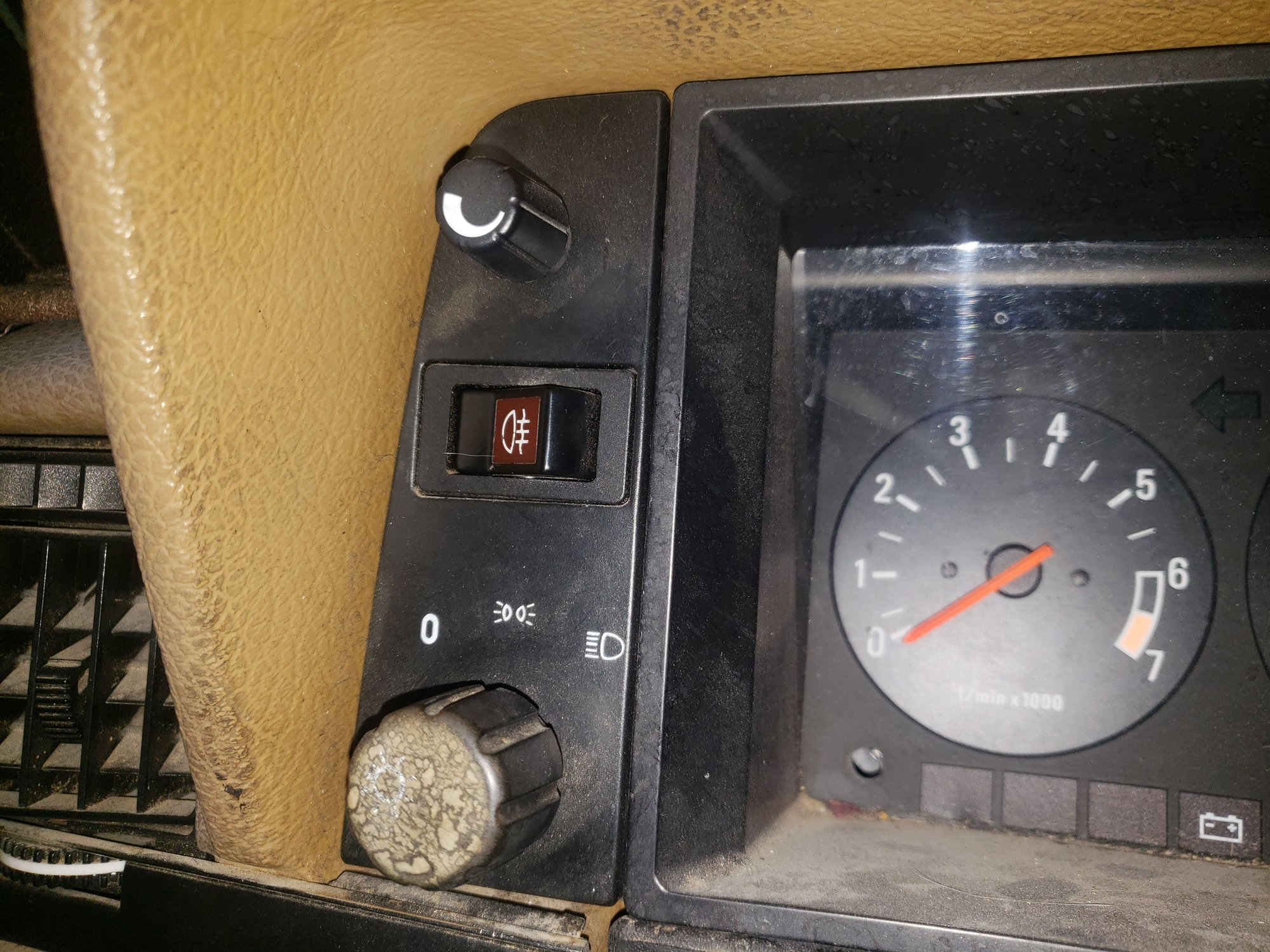

I am having a similar issue with my 1985 245. All the lights worked just fine when I first bought the car. Then I began seeing the orange bulb indicator on the dash while depressing the brake pedal. Now, my brake lights do not come on when the brake pedal is depressed at all and the orange bulb on the dash went away. The brake lights will come on when I flip the fog light switch to the "on" position while headlights are on. I've checked the brake light switch as well as the wiring. My car has the bulb integrity relay that is black. Not sure if its factory... its a 'hella' brand. I'm assuming the relay went bad and am considering bypassing it. What else could be the issue? Any help is appreciated. I am not new to working on automobiles but I am new to Volvos and Forums haha. Thanks in advance.

The bulb out relay has nothing to do with the rear fog lights. There is no reason to bypass it - you should be able to easily check with your $5 test light where power is or is not.
That relay only has the wiring for the rear parking lights, 3 brake lights and low beam headlamps. It cares about no other bulbs.
I would check the fuse for the brake lights first - it could have blown because the wiring for the 3rd brake light goes through one of the tailgate hinges - the wiring fails there and can ground out.
Are you certain your brake lights come on with the fog lamp switch? Or do bright red bulbs (in the upper position?)come on with the fog lamp switch? That's what is supposed to happen. The rear fog lamp bulbs are 21 watt, same as the brake bulbs. Parking filaments are 5 watt, brake, turn signal, reverse and rear fog are 21 watt.
The wagons don't have the problems associated with the "white versus black" bulb holders, and rarely have the melted connection problems the sedans have.

Thank you very much for the quick response! I was curious about the wiring going through the hinge. I was also unaware of the "rear" fog lights. Another safety option from Volvo i suppose? I will check the condition of the wiring through the hinge. I just assumed my car had been pieced together because it doesn't have fog lights in the traditional sense, or at the front of the car but it does have the switch. The upper portion of the tale lights are what light up when the switch is turned on. I visibly checked all the funky fuses and the seems fine but haven't verified with test light or meter. Again, thank you for the response.
Front fog lamps if installed would have a rocker switch with the others in the center console. The rear fog lamp switch is next to the headlamp switch - and turns on what you noticed when light switch is turned on.
Old Jan 11, 2022 | 09:21 AM
  #18
'85 245 VO's Avatar
Joined: Jan 2022
Alright! Well hoonk, I sure appreciate your help. I can't believe the knowledge you have with these cars. I really appreciate the responses and all your help. Just to verify, I've attached a pic of the switch that I'm hitting that turns on those rear fog light...
Old Jan 11, 2022 | 07:11 PM
  #19
Yes, that's the rear fog lamp switch. With Volvo (240) the front fog lamp switch icon has wavy lines pointing down not straight out and has a green lens in the switch.

I thought I would give some insight on my findings while trouble shooting today. I received lots of help from hoonk during this process. I was still unable to find a blown fuse and my car doesn't have a 3rd brakelight (possibly modified by previous owner) and there was no sign of a harness running through the hatch for 3rd brake light. I then stumbled upon a video from ipd where they state 200, 700 and 900 series WAGONS only have issues with the brake light bulb getting hot after extended use and melting the taillamp housings. The fix is either buy new taillamps or switch leads from brakelights to the rear foglight bulbs. The brake lights are relocated to the top position of the lamp now but work great! Here's the link to ipd's video... https://m.youtube.com/watch?v=6DOWyBdvKqA
