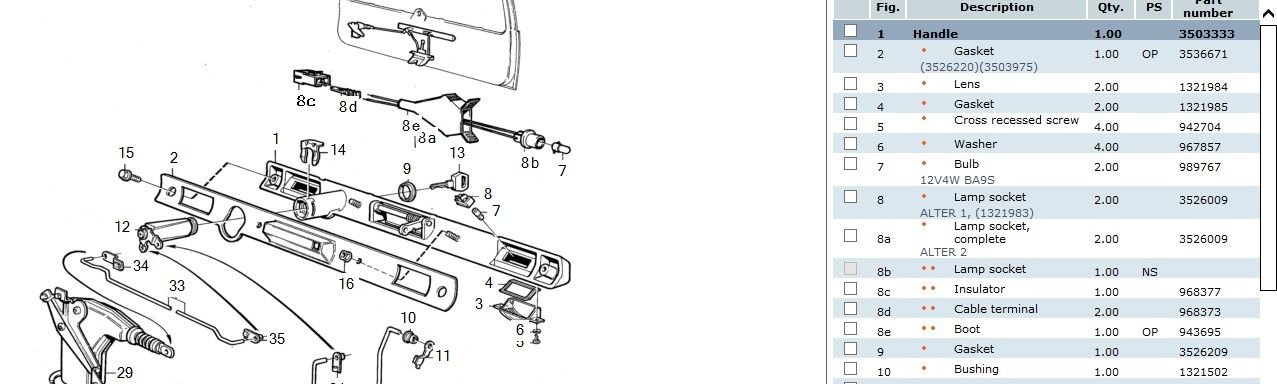

Might have a bad socket 3526009 - take the tailgate panel off then the handle off the tailgate to get to the socket
https://www.skandix.de/en/spare-part...light/1016766/

I did check the fuse, it's good. It is a 1990 wagon. I was thinking it was something to do with the wires but was unable to look as I could not get the tailgate panel off. I might just get a new harness and socket and be done with it. Any tips on getting the tailgate panel off? I got the plastic clips off but that was it, I never saw any torx bits or anything...

It's been a long time ---- Don't those have 4 visible 1/4 turn clips on the bottom edge, 4 hidden clips on the top edge, that break or the panel breaks where they slide in, and 2 torx screws that hold the pull down handle in the middle of panel hidden by the plastic surrounding the center panel that you carefully pry off?

I believe so, most of the clips are gone. The plastic surrounding the center panel that you pry off is just the inside door handle right? I saw where it had been chipped from what looked like someone trying to pry it off and I gave it a try but did not want to force it. I'll get a picture later.

Thanks for the tip! So you think I should just get a new socket?
Yes that part comes off to expose 2 screws holding the door panel on -
