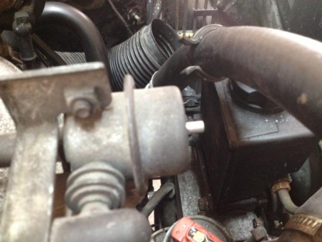

Trying to get this ready for start up, seem to be missing some connections after I put everything back together. (1993, 240, Wagon).
First one is what connects to the fuel pressure regulator?? I know it's a hose lol, but somehow I can't find the connecting one.

First: from pressure regulator to a small tube under the intake/throttle body

Alright, I think I got it.
#1 - found the missing hose from fuel regulator to the nipple under throttle, check.
