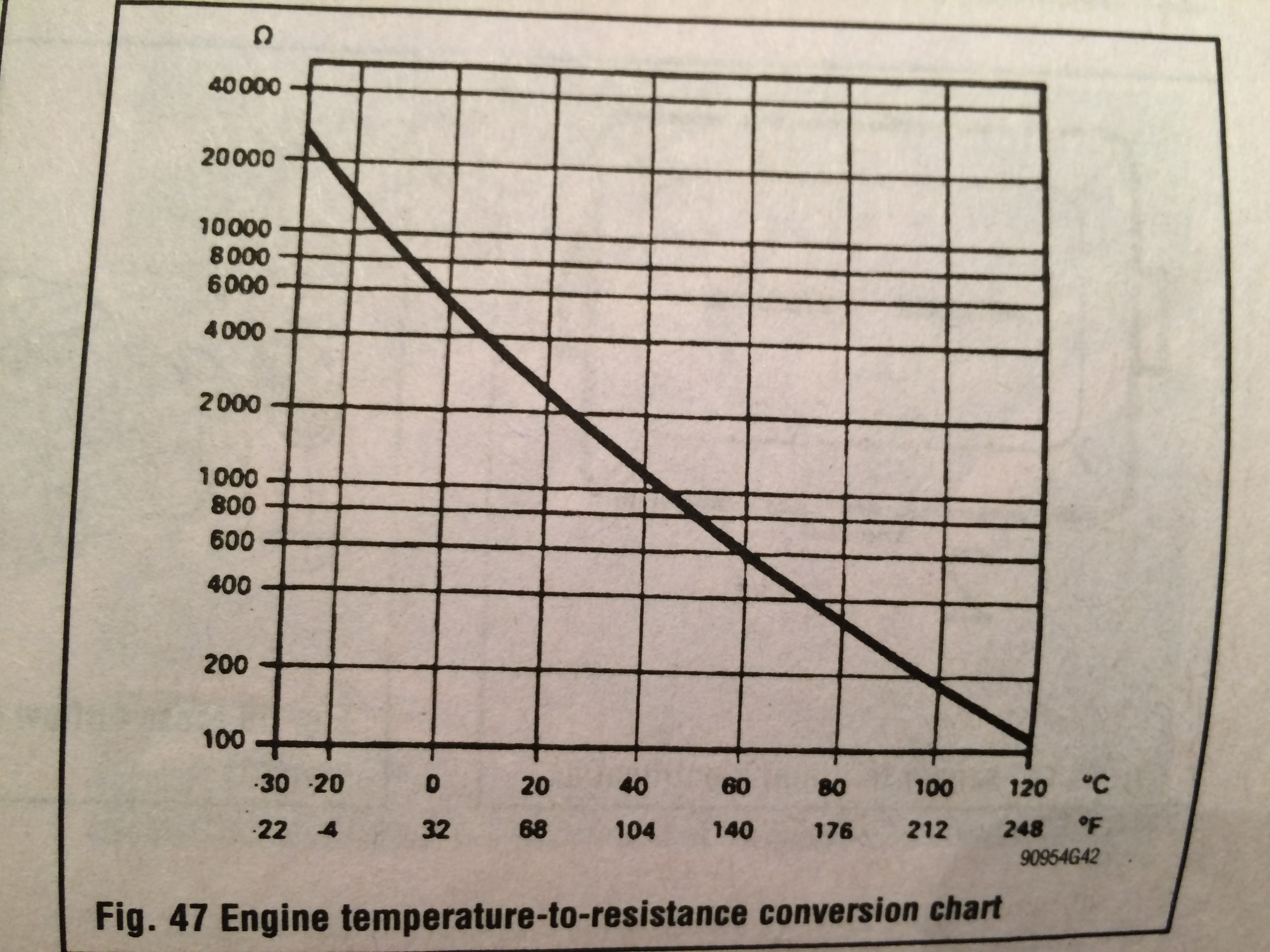

Sealed up the exhaust leak, I’m curious to what the O2 readings will be now
currently I am resetting the fuel trim and computer memory (leaving the battery off for an hour or so)
I also tested the Temp sensor, and everything looks good there so far. I got about 2100 Ohms at about 62 degrees Fahrenheit
I will check again at some warmer temps by idling the car and taking samples of the coolant temp, then cross reference it with the chart I found.
Attached Thumbnails MPG's flat on their face at 16-17 HW/Cit-img_0913.jpg

Ill go through he ECU today like you said. Looks like in need to back probe the connector and power the circuit. I like doing different types of tests because this is one part I would rather not change out...if I did I guess ill just take off the intake and clean the whole thing out while Im at it
Old Oct 2, 2016 | 01:33 PM
Nichals's Avatar
Joined: Mar 2011
Posts: 593
Likes: 6
Tested the temp sensor at cold warm and hot measuring the temp with an ir-thermometer and everything checked out 100%
