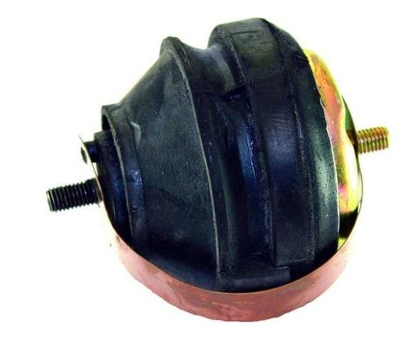

If the engine is running smoothly just vibrating at idle, worse when the engine is cold - Your engine mounts have sagged and are not absorbing the vibration of the engine. When bad enough, the pan pan will touch the sub-frame. The motor mounts are pressure filled - and very soft to absorb the engine vibrations. That pressure leaks out and the mounts sag. Check your trans mount also - they are just a rubber block, but can break and cause vibration problems.
I forgot to mention i just changed the tranny mount recently too. It doesn't look like the mounts are bad, but not sure. Why would it vibrate only at certain rpms though? It has a small misfire too. Can it be related? Or related to exhaust?

You could measure the height of a new one - (if they are 10 years old - they are sagging)

You could check the clearance between the oil pan and the subframe/crossmember. Or stand on the exhaust side of the engine, (hood open) grab the oil cap. With good mounts you can move the engine left and right. With flat mounts you can't

Disregard the comments of Hoonk on engine mounts... Its not that!
check the wiring and test the idle air contril valve.
Bad engine mounts wont cause your car too stall out.
1500rpms when cold could maje the valve itself sticky.
try cleaning it after all the checks are ok

That is true, flat engine mounts will not cause the car to stall. Flat engine mounts will cause a vibration, worse when first started and cold and that is one of the OP's complaints.
