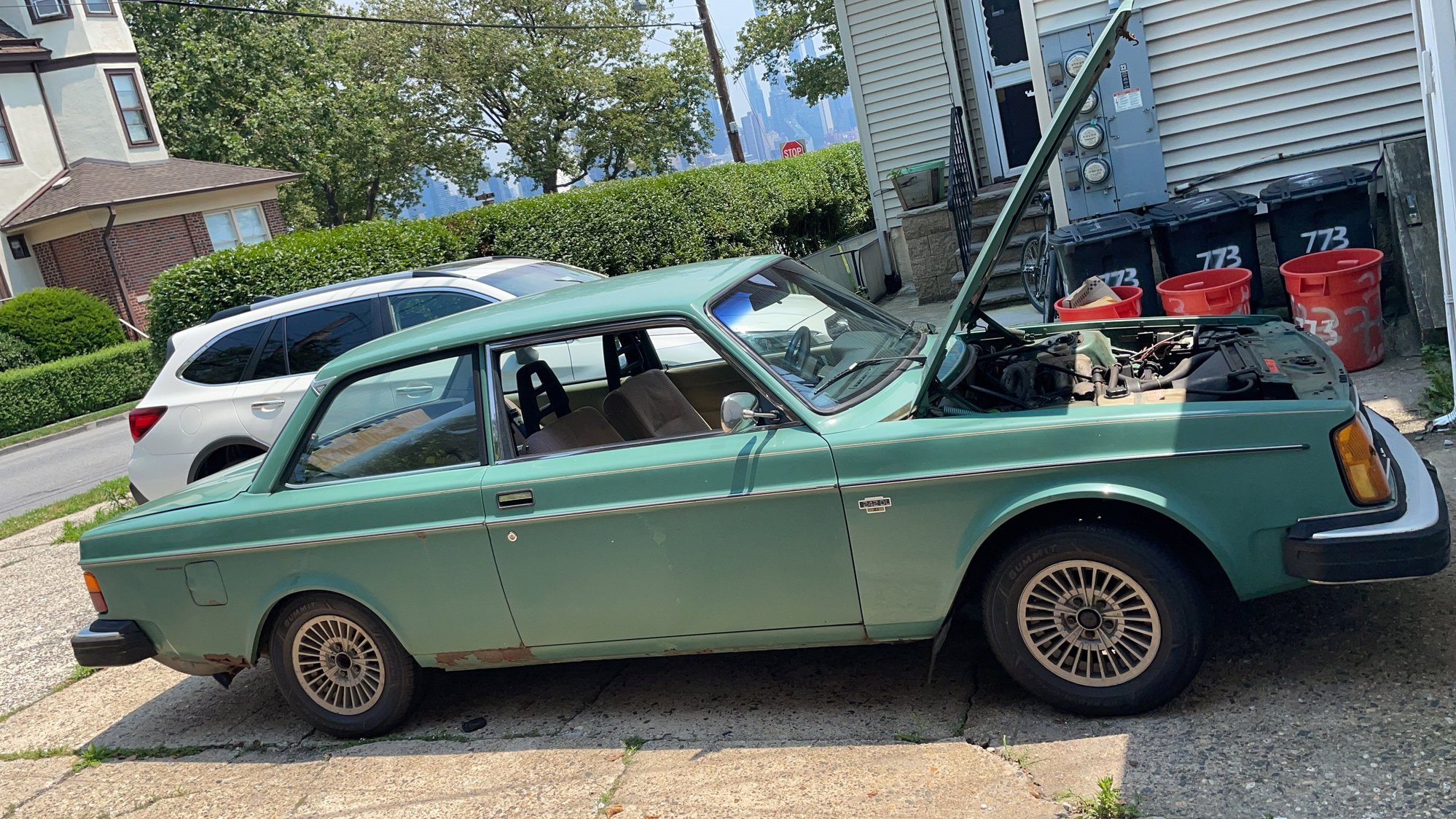

My 79 242 is running on aluminum wheels, plus, I have the original steel ones. I much prefer the look of the original steal ones, but they run very narrow tires.
Is there an steely option that runs wider tires without using spacers?

Your car uses a 5x108 rim with a 65.1 center bore and a 25 mm offset (on the 5.5Jx14s) or a 20 mm offset on the 6Jx15s. Look for some 6Jx15s from a 700/900 and you can run some 196/60-15s for a nice fit
I think something like this would work
https://www.ebay.com/itm/18479167093...gAAOSwnAthdEBZ
For specs, wheel-size.com is a good resource.
