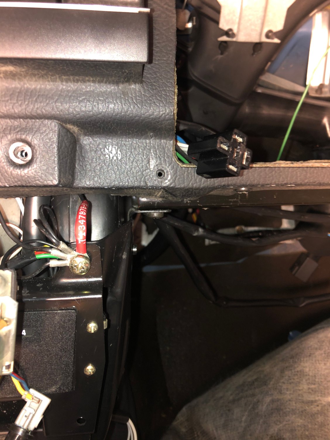

I checked 15, 86, 87 and 87a the same way as well and only 86 and 87 give me a tone on my multimeter. And they only do it when I touch the multimeter to the gold screw, NOT when I do it to the black frame that you see in the picture. Incidentally ground 13 wire is not touching the gold screw directly either since it's in the batch first, it's the one with the red sleeve around it.

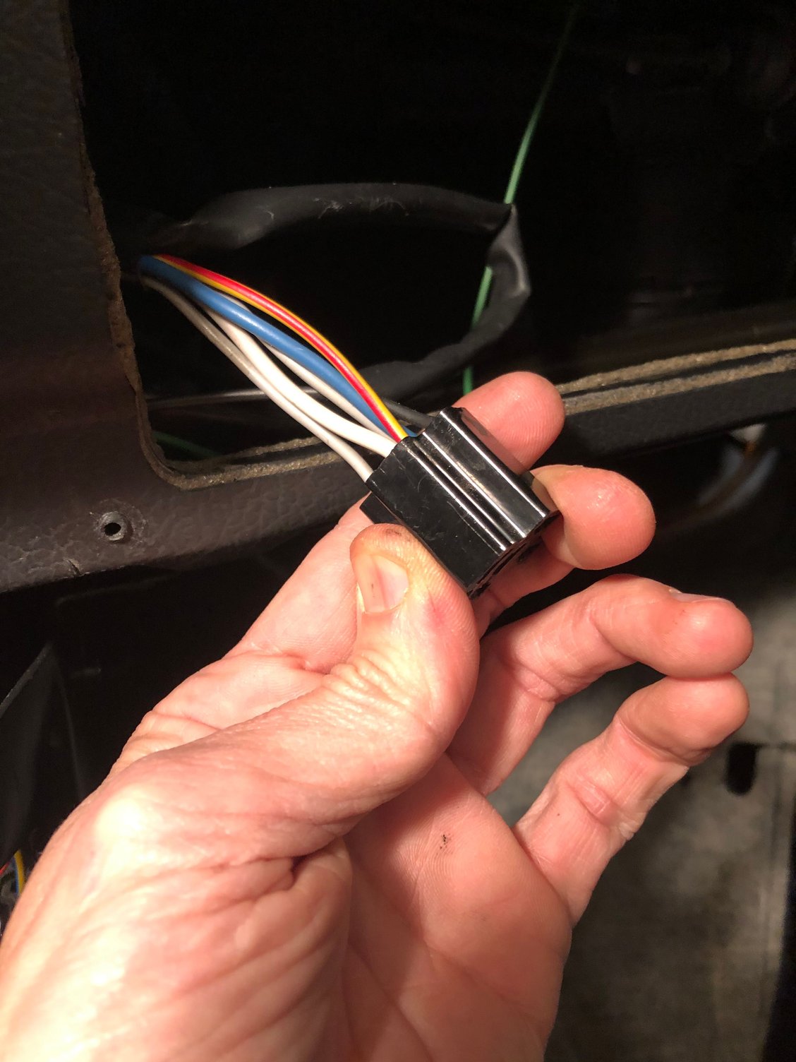

I got into my wiring diagrams finally.
the black wire from the relay socket should go straight to the ground screw on the right side of the center console.
the 3 pin connector according to the schematics, BOTH sides should have 2 grays and a white wire. in your picture, it looked like 3 white wires on one side, huh.
I was wrong about the pushbutton, at the relay, one side of the pushbutton is wired to pin 15 (power) and the other side to relay pin 86. relay pin 15 also gets a blue wire from the fuse panel, this goes via a 4 pin connector 'H' that is buried up behind the dash somewhere, and has a blue wire with fuse 11 power, and a yellow-red wire to the dashboard light at pin 34 (a separate spade lug which is right next to the OD light on the dash))
Old Feb 13, 2020 | 09:06 PM
  #28
sure you got the right relay socket? the door lock relays are right near -there, too, and so is the electric window relay.
the OD relay's socket should have wire colors liike....
pin 31 - black
pin 15 - grey and blue (2 wires)
pin 86 - grey
pin 87 - white
pin 87a - either white or yellow/red, diagram is unclear.

Posts: 139
Looks right to me. Check the pic I just took.

Old Feb 13, 2020 | 09:11 PM
  #30
well, with the ignition switched on, connecting pin 31 (black) to 87a (yellow/red) should have lit that dashboard light.
