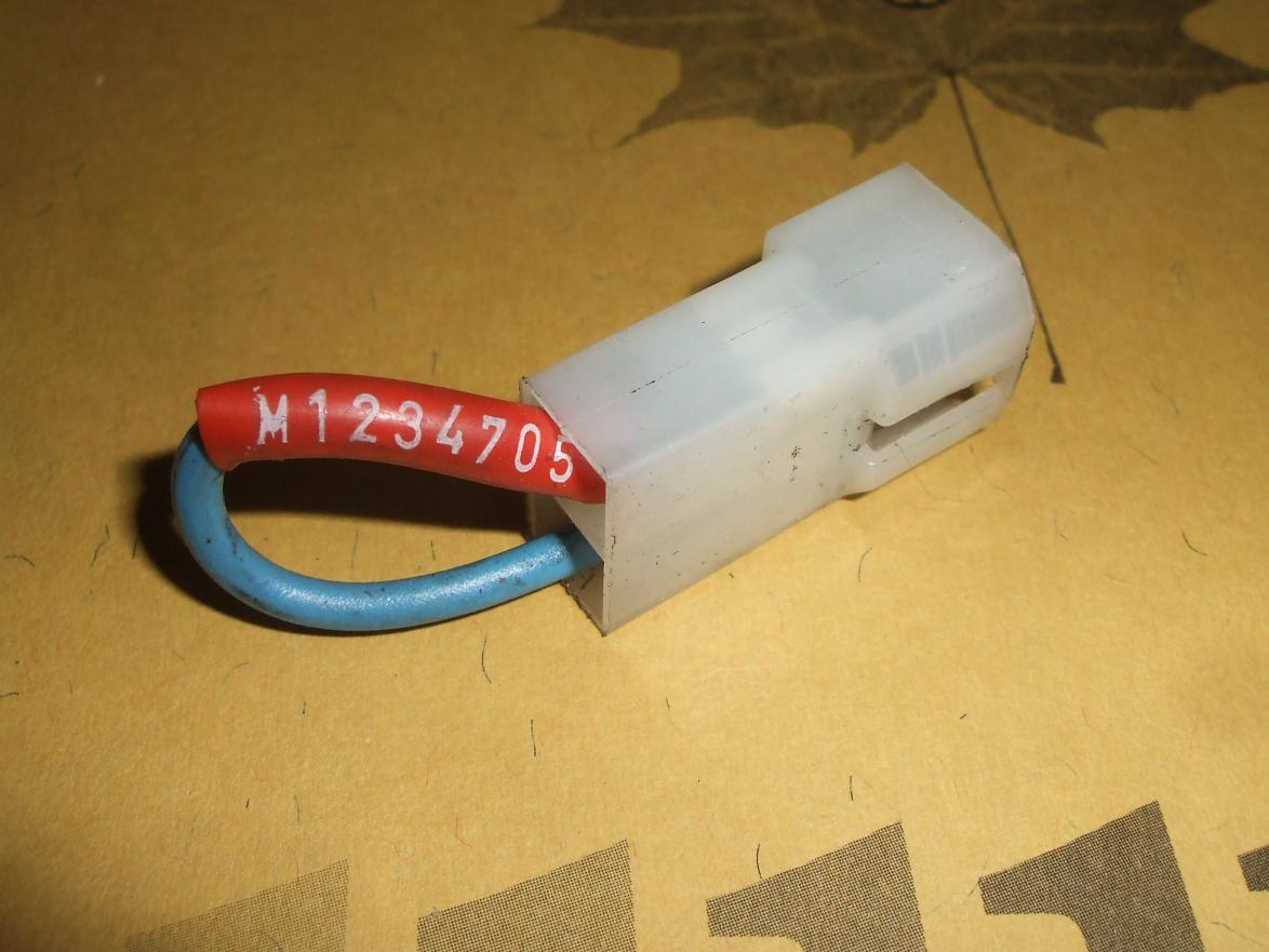

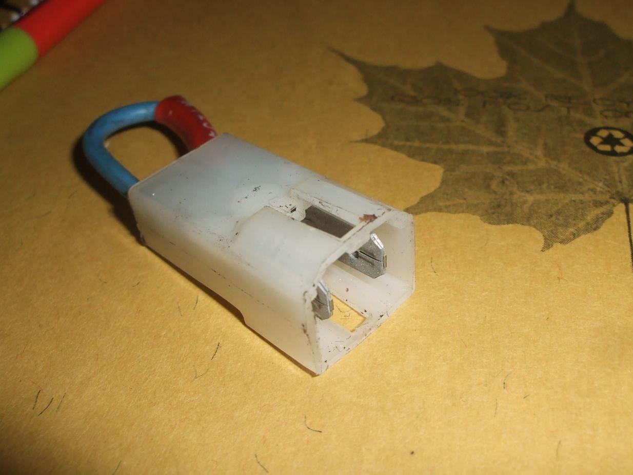

another bit to snag off that manual car... the automatics, of course, have a starter lockout switch in the shifter, and the sticks don't. this lockout switch is plugged into the harness somewhere near/above the transmision... on the manuals, there's a dummy plug in its place that jumpers pink to blue-green (I think thats the colors). of course, you could just whack off the connector and splice the wires, but if you can snag that jumper plug from the donor car, thats just one more little thing that will be neater.
edit; BZZZ, wrong colors for a 1985 240, see below.
Old Feb 11, 2013 | 09:57 PM
  #95
Titan Joe's Avatar
Joined: Jun 2009
Posts: 748
From: Utah (for now)
Is this the jumper? I pulled it thinking that it may be it. The P/N is M1234705 Just if you recognize it.
Attached Thumbnails The Snake: A 1991 244-dscf4648.jpg   The Snake: A 1991 244-dscf4650.jpg
Old Feb 11, 2013 | 11:47 PM
  #96
yup, I believe thats it. the 1985 wiring diagrams show the wire loop as blue, and its a 2 pin connector. the plug it goes into has 2 blue wires to one side, and blue-yellow to the other. one blue wire goes to pin 50 on the ignition switch, the other blue wire goes to the mechanics starter jumper under the hood, and hte blue-yellow wire goes to the starter solenoid pin 50. the jumper replaces the park/neutral starter lockout switch.
