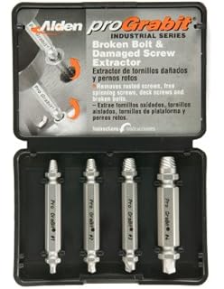

you make be able to get that broken bleeder out with a bolt extractor like this
https://images-na.ssl-images-amazon....SR248,320_.jpg
Otherwise a new caliper would be required
