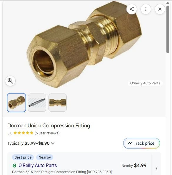

A leak free fix is to use compression fittings - (to replace the rubbed thru spots)

I don’t know why I didn’t think of this. Such a simple answer and fix. Thanks, much appreciated!
