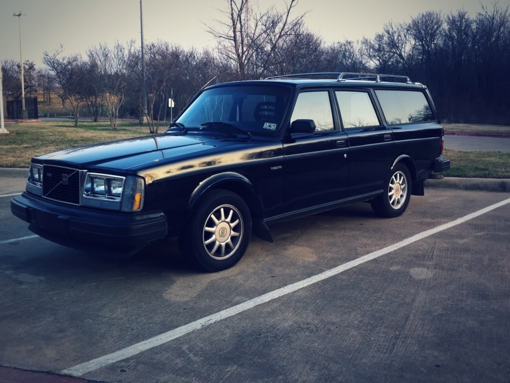

Thanks for the advice. Because of the A/C, I figured I'd offer $1600-1700, and deal from there. Anything I should know to look for if/when I czech this car out in person?
Here's a pic posted publicly, so I figure it's fine to share here:

Oh... I like, even the 700 series rims on them. Of course, that is the best lighting to cover imperfections, but I would look at this public guide from VCOA- Buying a Used 7xx/9xx
Yeah it says for 700 and 900 series car, the the engine and body principles are the same. Major things I would look at are the flame trap and rear axle oil, tranny oil and engine oil too I guess. Have any records? Check out the ball joints, does the rubber on it looked cracked. Is the tank more than half full? They might be trying to mask a bad in-tank pump, take if for a drive and give it some generous gas, does it feel like the engine is receiving more power the faster you go?

that looks really effin nice. are all the lights clear ? I replaced the turn signals and tail lights on our 87 sedan and it was 10x nicer.
is the interior half as nice as the exterior looks in that picture? most important to me is the drivers seat, and if the car overall is free of annoying rattles and clunks. yeah, that car *looks* like its worth at least $2000 in the local market here on the left coast. I'd want to see it up close, check some stuff, drive it before I'd say for sure.
those wheels are a fairly rare Volvo "Adhara" 15" rim.
Volvo 200/700/900 Alloy Wheels
stock on a 240 wagon was a 14", with a 195/75-14 tire... the 15's will take a wider stiffer 205/65-15 tire and were a factory fitment (but those wheels were probably optional or upgraded, I've not seen those on any 240s).

that car has upgraded 15" rims, so the door tire pressures are probalby incorrect. Stock was 195/75-14 and it probably has 205/65-15. I'd expect the /65 tires to need a little higher pressure than the /75 series with the same load

The ad states that the wheels are a later addition, and the interior looks pretty nice from the pictures, the driver's seat has cracks in the leather, but whatever. Pierce, what things would you czech?
