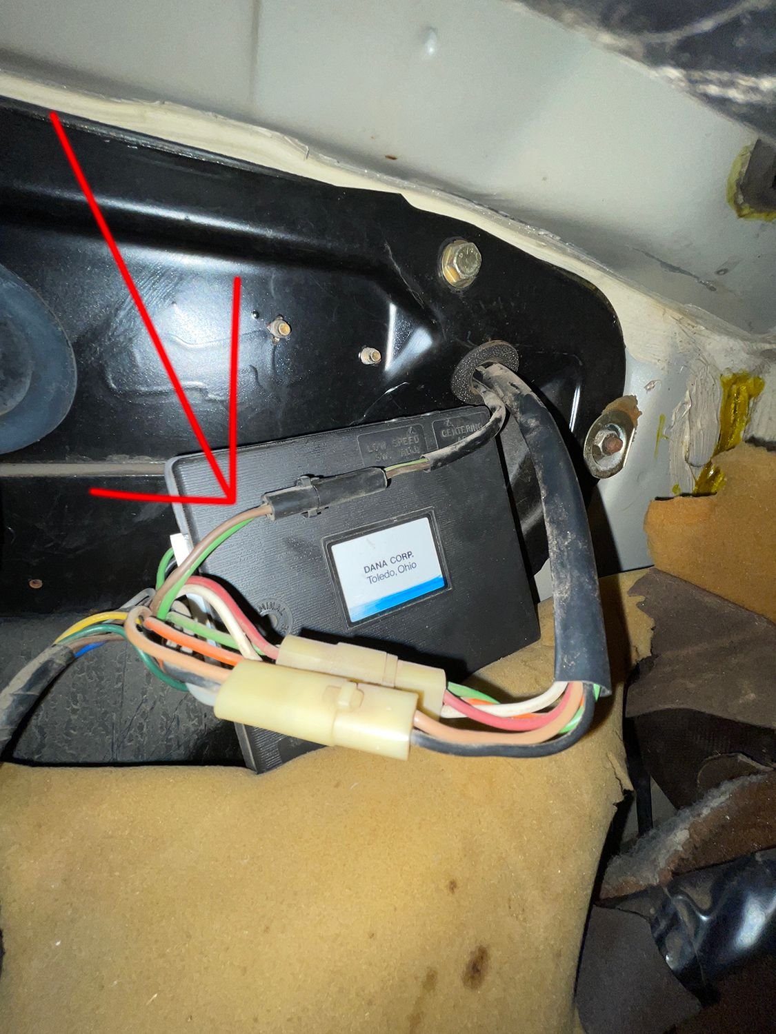

My 1985 Volvo 240 is currently not running. It will turn over fine but that's it. I saw that these wires were disconnected and after connecting them my no start was NOT solved and I 'm worried my car was running well before the no start and that these wires may have been disconnected for a reason....?? Any ideas? I'm afraid I don't know exactly what this box is either

What's this wire? If it plugs into that dana box - i'd bet it's part of the cruise control..

Thanks, I guess if that's the case I can try using that cruise control when I get the car going again! It certainly never worked before.
