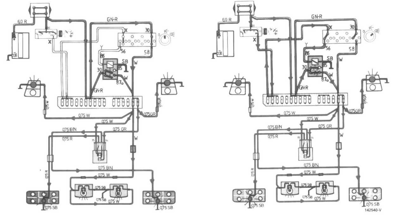

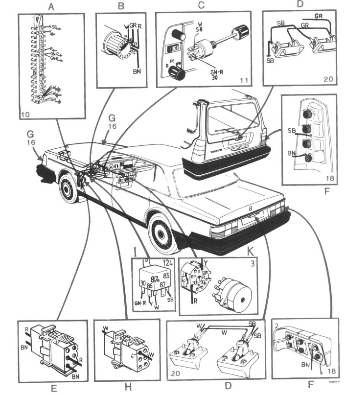

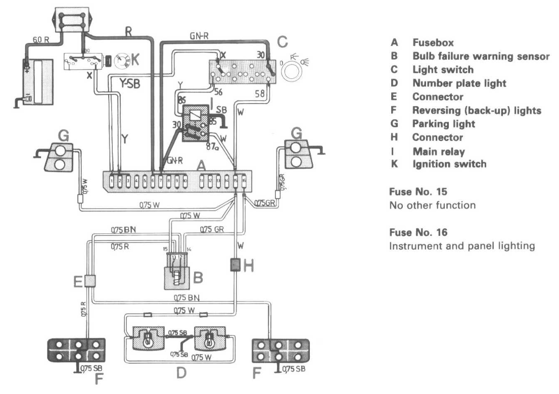

Hi folks,
I'm in need of a good wiring diagram for the rear lights on a 1990 240 DL Sedan. The ones I have found on the internet are either incomplete or they contradict each other. If you have one or know of a link to a good one can you please post it? Many Thanks!!
Old Nov 8, 2023 | 09:14 AM
doublerun's Avatar
Joined: Nov 2022
Posts: 32
From: WA
Here's what I found in AllData Repair,
Wow ...thank you, that should be just what I need. Much appreciated!
