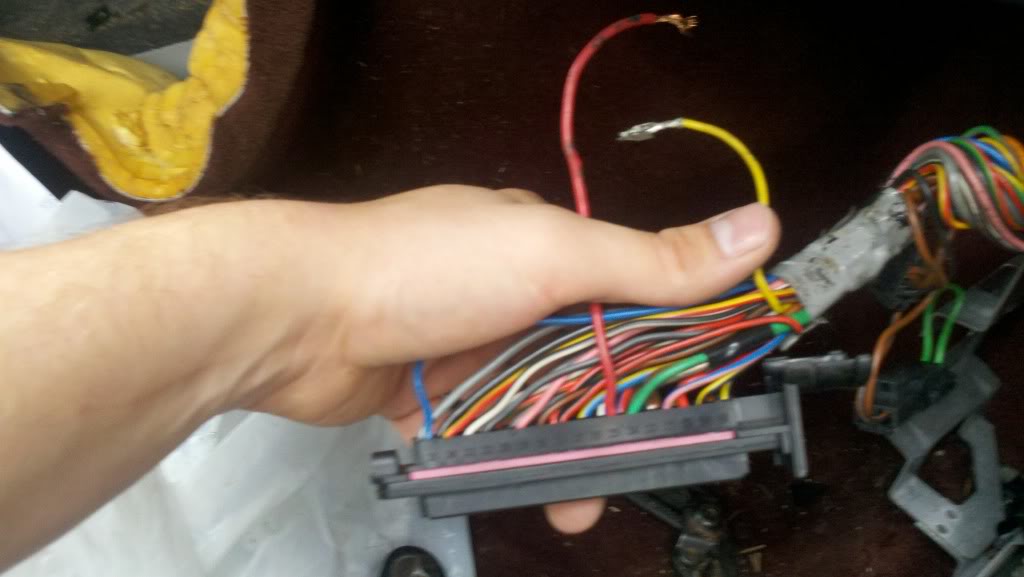

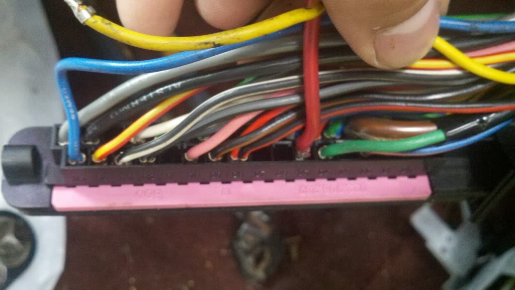

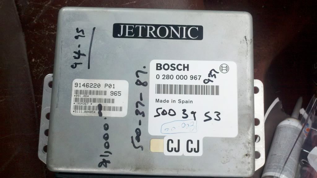

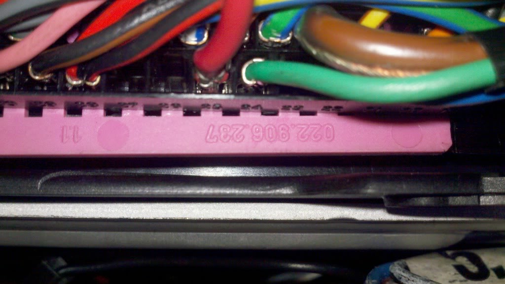

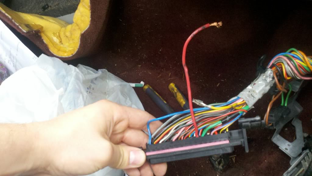

I got a suggestion it may have something to do with the ecu so I took some pics. There were 2 "loose" wires. I dont know where they go if anywhere. I have a pic of the ecu too. Do I need to replace the ecu. Also to help with the "loose" wire placement I have a list of empty pins on the ecu connector.
Empty pins: 3, 10, 11, 16 , 23, 26, 27 and 31 are all empty. Not sure if they are supposed to be or not.

Sorry to hear that your is not running well now. I replaced the crankk speed sensor. The car runs great now over 1000 rpm, then dies if the car drops below that. When the car starts it runs for about 30 seconds to a minute then dies, if I rev the car up over 1000 rpm it will stay running. I have done everything Beranimus has done accept change the fuel pump relay. it checked out fine. there are no more codes to follow now so I am in the dark on this one.
