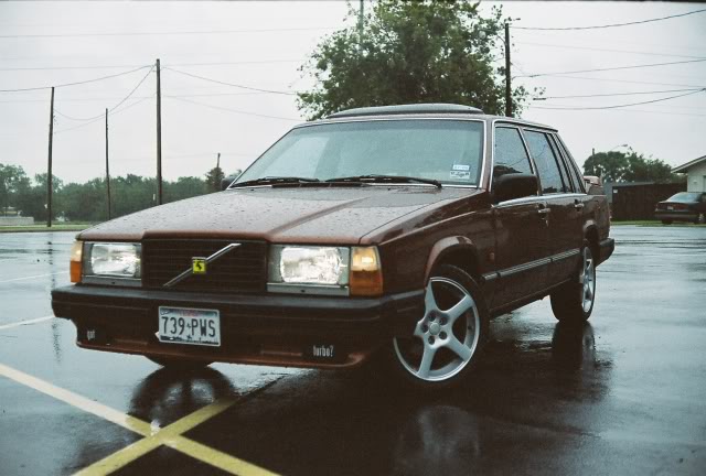

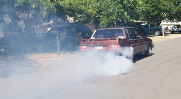

Until recently, I had an 84 760T. Of all my cars, it was the most fun for the least amount of money. And...effing gorgeous!!
