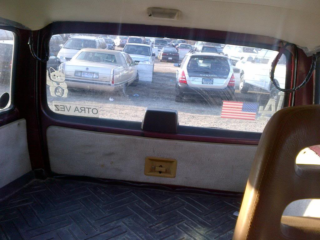

Here are some pics
With the tailgate opened
With tailgate closed
