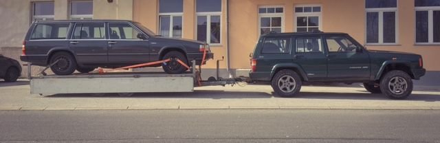

Hi Everyone, Greetings from Europe, i need Help!
I am currently in the process of registering an imported 1989 765 from Germany in Austria.
