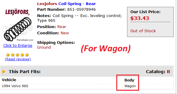

1994 960 sedan, I happened to be looking at suspension parts on Partsgeek.com and I see 2 different part numbers for rear springs for my model year with multilink suspension i.e. Nivomats.
This site is sales only no technical support help. I was wondering, how can I find out what the difference is between these 2 different part numbered springs for my model year sedan, if there is a difference? The first 2 pictures below for a sedan look the same. But if one has a heavier spring rate than the other, that's the one I would want regardless of price. The third picture is for a 94 960 wagon, to show the obvious difference in design for the wagon with a smaller diameter coil at one end of the spring versus the sedan springs.
Just curious if anyone had any thoughts. I looked up Lesjofors website and they didn't have technical details for specific springs for specific cars.

The Lesjofers website you mention only has a choice of 1 spring - and none of the part numbers match up with the partsgeek numbers - Volvo # for that spring is 9140681 or 1387836
