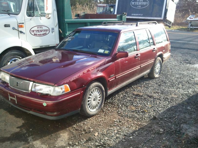

here's a couple of before pics of my 960......ive replaced the tailights, fixed 2 door handles, the hatch release a fuel pump and have to do shocks yet and the blower motor noise ...a.work in progress...paid 600 bucks for the old girl

That's great. I like red wagons. Is that rack aftermarket? Good thing about yours -- you have the front valance (black plastic band under the bumber cover). Are you upstate?
