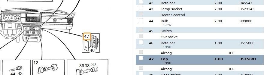

Originally Posted by rcutchins
'92 240 what malfunctions would/could present themselves with a glowing SRS light? .
Air bag light on means there is a self diagnostic code stored in the SRS control unit. To retrieve the code/s you ground the terminal under the SRS cover on the dash as shown below. Securely ground that terminal for x seconds and the srs light flashes a code. Secret code book tells you what the flashes mean. After all codes are read, ground terminal for x+ seconds to erase the code/s. That info is in a green service manual I no longer have access too - or I would give more detail.
Does your service provider have that info? That may be why he is waiting to finish everything else first. - Might be going to punt on fixing the SRS.
That early system is difficult to get the codes to appear. I trust your VA inspection is a safety inspection and part of that is verifying the SRS light works and goes out (if no faults are detected). So removing the light bulb is not an option.
What malfunctions might be present? Code retrieval would be the first step. That can happen in a few minutes. Then for example if you get a air bag code and test the wiring to the air bag finding an open circuit in the contact reel - a contact reel will have to be ordered, replaced and the code cleared. Or sometimes simply reading and erasing the codes will keep the light off the next time the car does it's SRS self test (that's when you first turn the key on) Or a false code could have been stored if someone had disconnected the air bag and turned the key on maybe during a horn repair or steering wheel centering. Then a simple read and erase would take care of that after the air bag was reinstalled.

rcutchins, I've seen the SRS light come on, on a friend's '92 240. It was during the time that the battery died. The first sign of the battery dying was, dash lights started flashing and stuff. Then after the battery was replaced, the SRS light remained on. I found the steps to reset the code (I didn't bother to read the codes, I sort of knew the dying battery triggered it) and afterward the light never came back on. Maybe you'll get lucky and you just need to reset the code. Let's hope. It is as Hoonk described, you literally just ground a wire to a terminal for so many seconds.
And yes per Hoonk's comment, Virginia state inspection includes verifying that the SRS light operates, i.e. comes on when you turn the key to the On position and goes off after starting the car. He rightly stated that the SRS lamp can't be removed.
I did a Google search for Volvo 240 SRS light reset and found this, which happens to be on this forum volvoforums.com. Looks right to me from my recollection.
(1) No B-block in engine compartment. SRS access cable in console behind panel marked "SRS" and between R/W DEFROSTER and EMERG FLASHER SW's. Pry panel OFF carefully, remove cigarette lighter ****;
(2) Make jumper between SRS cable (6-8 in) and cigarette lighter metal case, GND for 2-5 seconds, IGN switch is ON (may have to dissemble SRS connector for easy access to pin in cable, single strand wire for jumper is very convenient);
(3) Remove GND, SRS will flash indicating code stored in memory. Mine flashed 5x, (i created fault, disconnected SRS module at steering wheel w/ IGN sw ON...not good!!!!)
(4) Quickly GND again 3x within 5 seconds momentary gnd at cigarette lighter, SRS light should go OFF. If not repeat again, sequence and timing very important.
