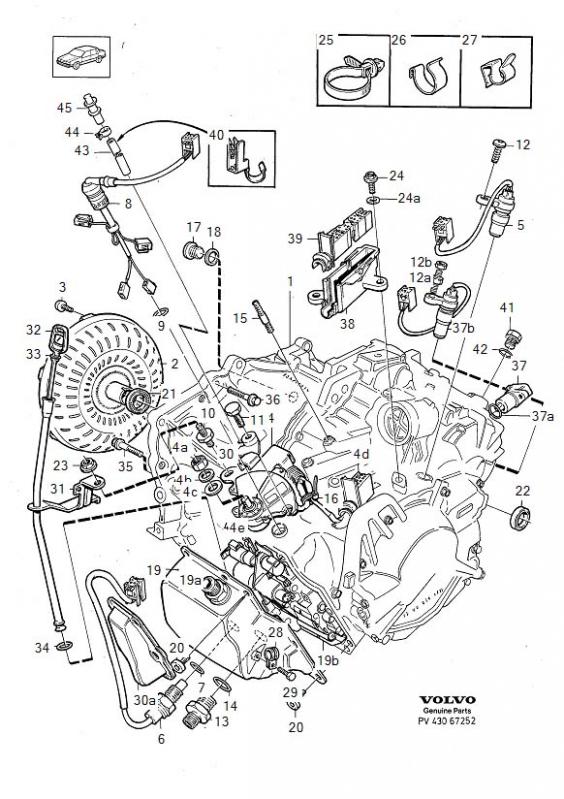

To be more specific: It is a 1996 Volvo 850 Wagon (non-turbo). The problem is a cracked transmission fluid dipstick tube/pipe, you know the metal piping in which the dipstick sits. It is cracked and leaking fluid. I just want to know if it is easy to replace this tube/pipe and where I can find the piece. I looked on FCP groton and found no such part.
Old Nov 28, 2011 | 01:21 PM
Now that makes sense. The tube is held in place with one bolt. Take the bolt out and pull the tube out. Slide another one in and tighten the bolt. Usually people replace the seal at the bottom of it as well. I suggest you get it from the junk yard. It will be easier to get the 1 bolt out if you remove the battery and battery trey, you'll be looking right at it. However, it may be possible to get it out easy without taking the battery out.
Thanks for coming back and explaining yourself. Really drives us (people that want to help) when someone comes to the site, leave a vuage statement, then never returns. Thus the crazy face.
Old Nov 28, 2011 | 11:17 PM
The tube is replaceable without too much trouble. One nut holds it in place and you'd be best off replacing the "O" ring at the bottom.
