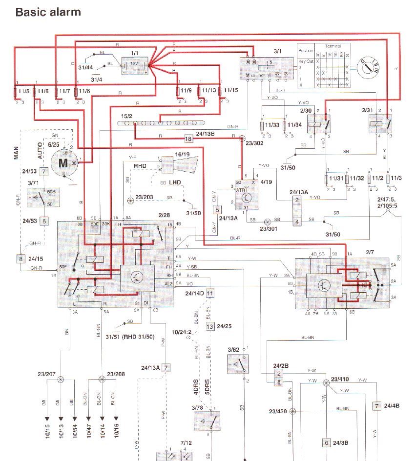

Here's a wiring diagram focusing on the immobilizer. The transmission safety switch looks like a relay here (to me) but it's the switch at 3/71
jpg
I suppose the "right" thing do to would be to see if you have power at this switch and whether it comes on during "start" (need 2 people to do that). That'll tell you if the immobilizer is involved and if the transmission switch is turning on and off. If the immobilizer is involved, then I don't know what you can do about that. Over my head.

The mechanic installed a new PNP switch. Are you saying it might not be getting power from something else? I have no clue how to test it though. Not a DIY guy.

Well, print that wiring diagram and give it to him.
