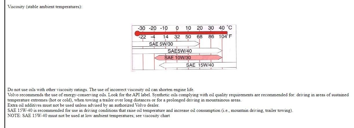

Your owners manual is found at
https://volvo.custhelp.com/app/manua...ual/om_id/1062
I'd use full synthetic if it were mine - (on a turbo car)
