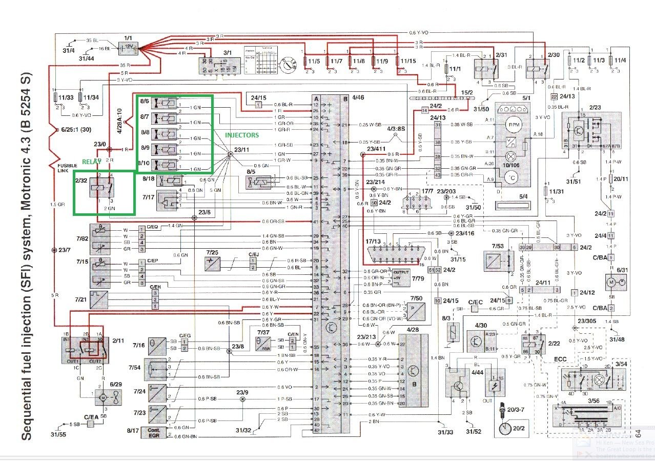

On the diagram follow a red highlighted wire from the battery 1/1 labled 5R to 2/32 relay. When that relay is energized power is sent thru the green wire (GN) to all the injectors (and a few other things) So you will find +12v at the injectors all the time (with relay turned on)
The injectors fire when the control unit 4/46 provides a ground connection - follow the other wire from each injector back to the Control unit and note the little ground symbol - at connection A10 for example. .

I am getting 12v when the test leads are on both injector pins, not on one pin and the other to earth. So if one of those pins is ground, shouldn’t the meter be showing a pulse when turning over the engine?

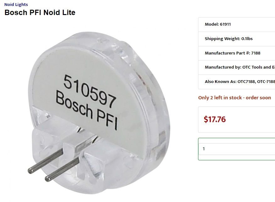

Your meter does not have a fast enough sampling rate to detect a voltage change. You need a simple noid light (that fits your wiring) if you want to verify the injector pulse.

If you want to poke at this area, then they make something called a "Noid light" that you would plug in place of the injector and it will flash when the injector is told to turn on. if you're interested in that sort of thing. Oh, sorry, you already got that. I'm behind, ha ha.
