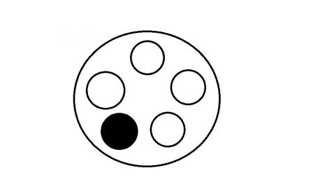

i need to know what is plug #1 on distibutor and the correct firing order ive seen 3 different versions so far from clockwise rotation too anticlockwise rotation and bottom point on distributor as #1 and left side as# 1 and top as #1 -- is there a chance that sum 1 vets the stuff posted to make sure its actually accurate as possible? my guess is its #1 left center on dist cap and rotation is clockwise looking toward timing gear and firing order is 1-2-4-5-3

The number one spark plug is the bottom left one on the distributor. It is the black dot in the picture I made.

So you are telling me that the rotation of the intake camshaft is counter clockwise as im looking at it correct???
