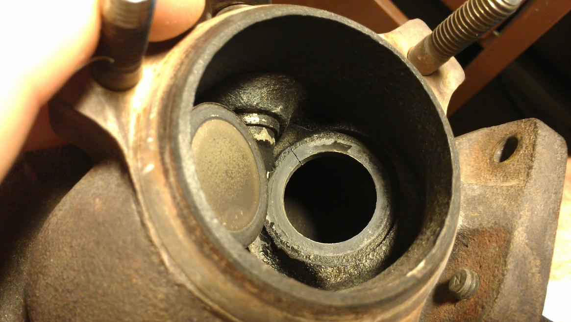

Originally Posted by slimflex2
can a faulty wastegate cause low boost across the board?thank you
If it's not seating correctly or it's being opened too soon, sure.
Or ... this is a long shot, if the exhaust housing cracked.
Attached Thumbnails 850R boost problems-turbo-common-crack-bypass.jpg   850R boost problems-turbo-bypass-valve-shifted-position.jpg
wow brother thats right. l was seafoaming my car about a week ago and saw smoke come out from behind the heat shield. thats not a good sign l think. and when l reved it l hear a pop sound coming out from behind the heat shield.l think l will have to take of the turbo and take a close look at it. but let me ask you, when taking off the turbo, do l have to drain my anti freeze? thanks alot for ur input.

Yes and no. You can either drain it or it will drain down to the level you take off the coolant hoses going to it.
It's would likely be cleaner if you drained it from the lower hose or petcock as it would be easier to catch and not as messy as at the turbo.
No, you dont have to drain the anti-freeze, just put a bolt or something in the line to plug it up.
