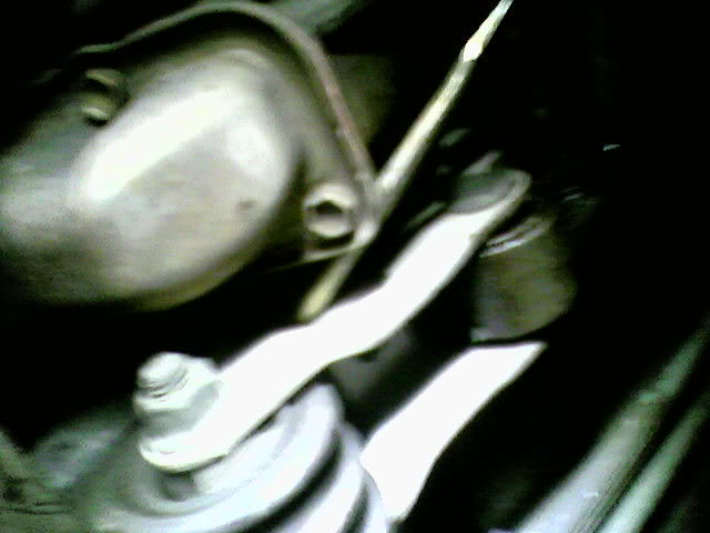

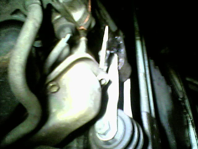

so i finally got the time to go out and look today while changing my oil and i think i found the perpetrator. there was a medium sized flathead screwdriver wedged in between my tranny and the tranny mount obviously pushing the tranny up some relieving weight off the mount(which looked like it was pretty worn possibly missing the smaller side bushing) i tapped out the screwdriver after changing my oil and started up the car and as i went between R N D the engine seemed to shift slightly i don't know if this is a normal trait for the auto tranny on the 850 turbo or T-5R but it was noticeable not huge but noticeable. also the noise it was previously making in reverse seemed to change slightly like more of a metal on metal vibration then a rattling. any suggestions or this this one right in front of my face replace the tranny mount?
pics of the tranny mount (forgive the bad quality all i had on hand was my cell phone)

What a perpetrator[8D].
If you did not see any metal rubbing marks around where the screwdriver was, it could be rubber/urethane bushing that has retired.
Wait to see what Tech would have to say on this.

there was definitely metal on metal marks around it. it wasn't just setting in there it had the whole weight of the tranny on it like i had to get a hammer and pound it out. and as for the tranny mount i am replacing it but should i replace all motor mounts too since the motor itself is moving when i shift or would the tranny mount cause that too?

I would replace that one and inspect all other mounts.
