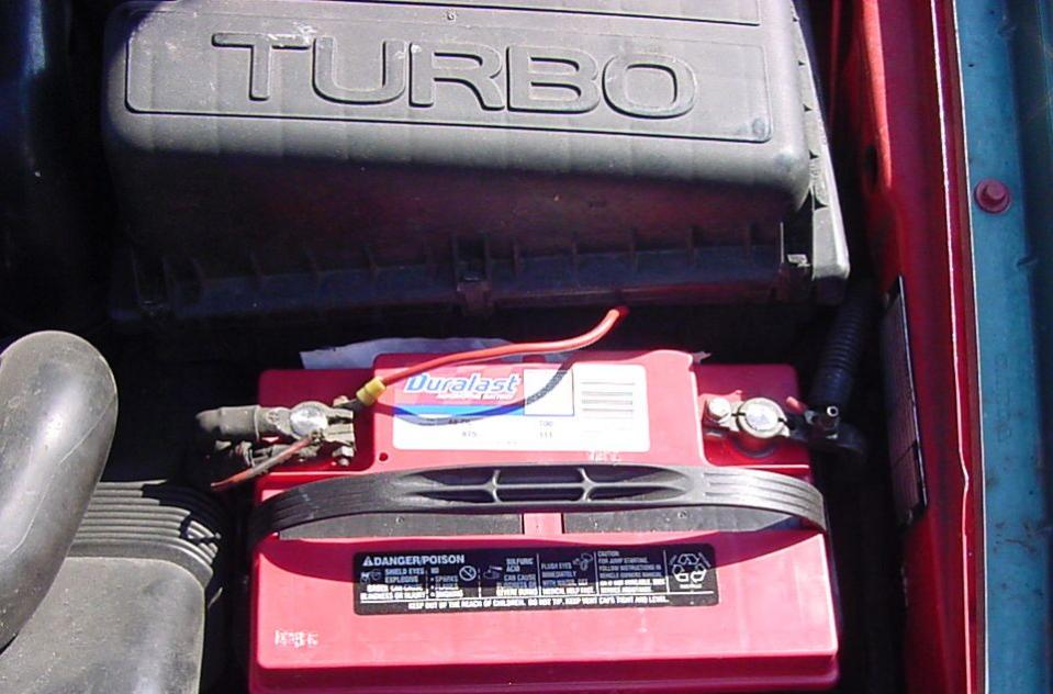

If it only seems to be abnormally slow in the really, really cold stuff I'd go to the 5W30. Would still recommend checking all the connections and having two different auto parts stores or tire stores check your charging system. I'd do two different places as they would have a different brand of tester from autozone to oreilly to sears to goodyear ... etc. That way if two places say it's good it likely is and it's just a well worn starter or a connection that needs some attention or the thinner oil. When the do the electrical system test it's battey, starter and then alternator. Ask them to watch for and let you know the starter draw. I don't know right now what it's supposed to be but post yours and I'll research.
IF . . . If someone needs a battery the stock battery is a group 47. You can step up to a group 48, same width, same height just a little longer and fits fine in the battery box looks identical to a group 47.
You can also use a group 24F. It's a bit taller but there isn't a clearance problem in an 850. I'm running one now because my 48 died and at the time a replacement 48 couldn't be found. The reason to go bigger is to get more Cold Cranking Amps (CCA) from the battery.
The photo is of my "late" 48
Attached Thumbnails 97 855R - slow cranking in cold weather-battery-replacement-48-47.jpg
