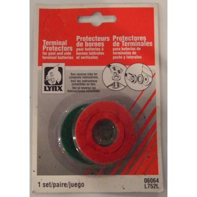

And if you get a chance, pick up a pair of the battery washers with the new battery. I used to think they were crap till I tried a set. They really do keep the corrosion down on the battery. I just wouldn't use them on a side post. They tend to get in the way of a good connection IMHO.

I'm with Kiss on the post pads.
