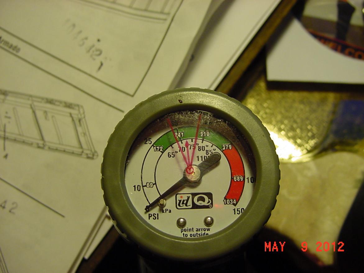

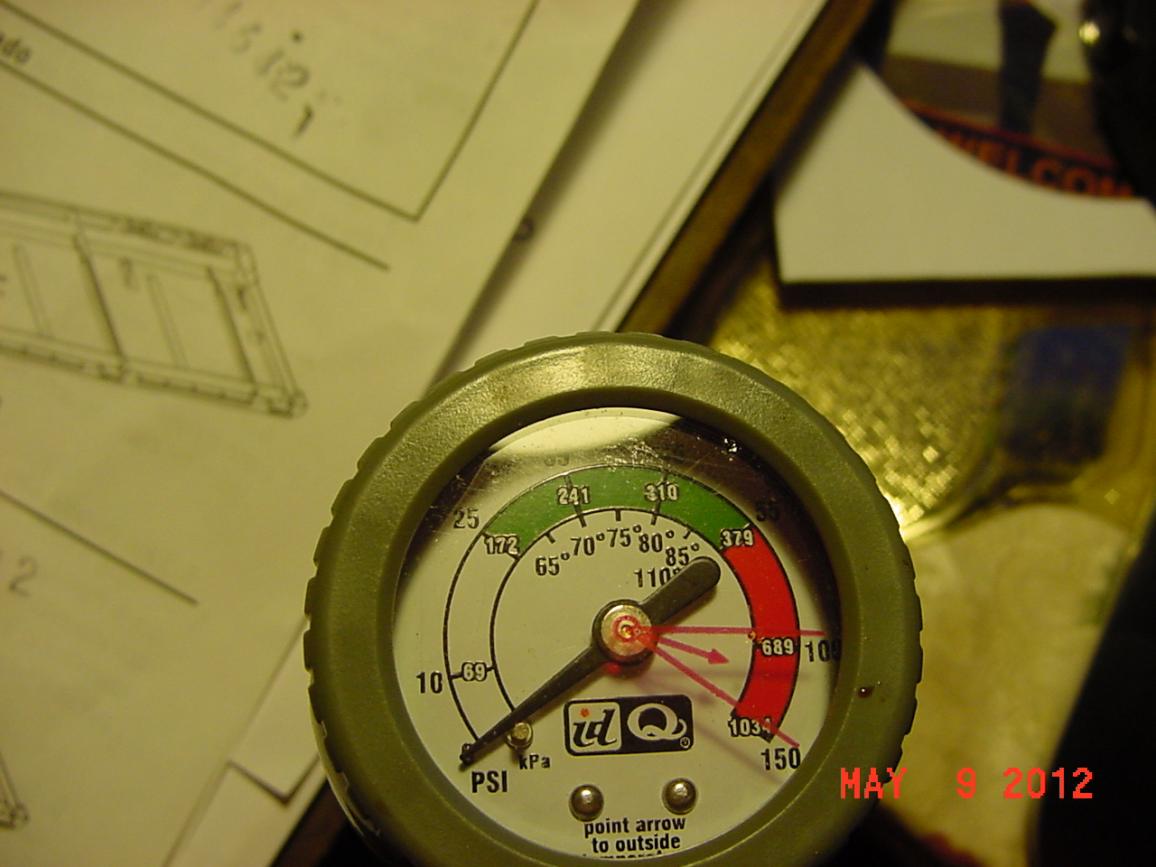

Old May 8, 2012 | 04:37 PM
45 psi is kind of a general pressure. It is not the perfect pressure but it is an accepted general pressure for the DIYer who doesn't have an accurate weight scale or the evacuation equipment.
Depending on the cars type of system (there are variations), the temperature and the humidity the desired pressure on the low side for a properly charged system will vary. There are charts for charging but it's a best guess at an imperfect way of doing an addition. The higher the temperature and humidity the higher the "low" side pressure will be due to more load on the system trying to transfer the heat energy out of the vehicles interior.
If it was really hot, say over a hundred with about the same in humidity it might be correct to go to 60 psi or even a little more but it's unlikely your going to be doing it on a day like that. Some of the cans come with gauges will have a dial that will turn to adjust the sweet spot for the ambient temperature so if you're picking up a can you can check one out. You turn the dial to the days temperature and it has an embossed or raised "V" that gives you an area in psi to aim at. It's still just a guess but it is helpful for the first time DIYer.
It isn't the low side that will cut you off at 60-65 or more psi it's the high side. As you raise the low side by adding freon the high side is the one that is climbing more. What would happen is you would be hitting the high pressure safety switch that would save the compressor from trying to compress an amount of freon it couldn't and either damaging the compressor or blowing a line. The high side safety is somewhere around 550 to 700 psi. I'm not sure the exact pressure but if your pushing 60 low you're likely to be somewhere 450 to 550+ high side depending on temp and humidity.
Trust me, if your charging it on a hot day, 75-90 degrees then 45-50 psi is your best bet unless you break out that chart from the internet and go to a weather channel and get your temp and humidity and plot the pressure for your type of system.
The picture shows a gauge off one of the refill canisters available. It goes red at 55 psi. They don't recommend going above that. The arrow in the center of the two red lines gets placed on the temperature so as the temperature increases so does the recommended pressure for a proper top off of the freon.
