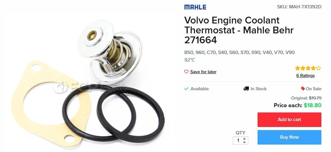

Thanks for your reply. That sounds like it's beyond my capabilities as an amateur mechanic--especially since I don't have a garage to work in. I think I'll get the part but have a professional do it. Would this be the only part I would need to get?: Engine Coolant Thermostat.

That's the right thermostat for your engine - but there are many quality aftermarket thermostats (some are the OEM manufacturer) that are the same part sold for much less but not in a Volvo box. As far as "I think I'll get the part but have a professional do it" - I owned a shop for 38 years. I would not install customer supplied parts. Well I would, for up to three times the labor cost and NO guarantee that the part would work or it would actually fix the problem. Nobody ever insisted I put their parts in.
A shop, to stay in business has to make money on both parts and labor to be able to pay for business related stuff - Insurance, workmans comp, salaries, benefits (health ins/vacation/training/etc) utilities, rent, special and scan tools $$$$, and a bunch of other stuff.
You might be able to find someone to install your part - but how are you going to feel when it does not fix your problem? Are you going to write a review exclaiming how that shop ripped you off? (Yes, that's done all the time)
In other words - you are not going to save any money by buying a Volvo branded part and taking it to a shop to be installed. Call your local Volvo specialist, first ask if he will work on a car that old. (many shops won't) If he will tell him your symptoms, explain that you think it might be a thermostat and ask for an approximate cost to replace it. The cost will be diagnosis, labor, tax, shop supplies and parts. He may insist on all new antifreeze - although if in good condition new antifreeze is not needed for just a thermostat, just a top up. (if you clamp the upper hose and the small hose on the coolant bottle you will lose just a few ounces)

I will contact the mechanic and tell him what you said. If I understood correctly: if he breaks the bolt, he can replace the thermostat housing -- figure 1 in the diagram -- and needs two gaskets also -- figure 3.

Roger. I talked with him when I picked the car up. We agreed I'm going to track down the thermostat housing (figure 1 in the diagram -- and two gaskets, figure 3) so that, if he has trouble, he'll have the housing in hand. Thanks again.
