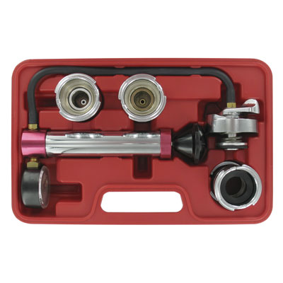

If it's not going into the engine it's dripping someplace. Try putting cardboard under the car when you park it while it's still hot and try starting it up cold and idling it over the cardboard to see if you can see any spots.
You can also get a pressure tester from an auto parts store and pump up the pressure to see if you can find a leak and there is always automotive cooling system dye to use with a black light to locate a leak too.
The pressure tester is a loaner tool so you don't need to purchase and keep, just use and return. If you get it make sure you get the adapter for the screw on cap 850s use.
