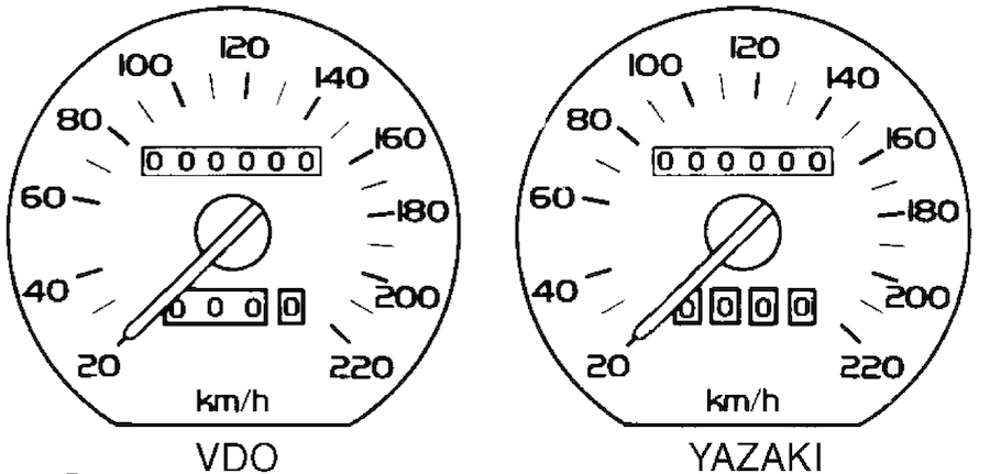

There were two different manufacturers of cluster for the 850, Yazaki and VDO and from what I know they are not interchangeable

plenty of clusters on eBay for about $75 to 100 USD. I've gone that route in the past. Never seen a Yazaki in the US - good to know.
