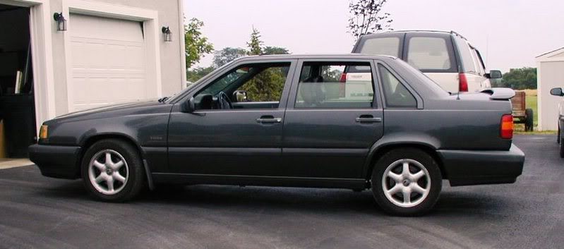

96 850 T5 sedan. Dark gray, about 200.000 kms. I´ve had it since March 2006.

I liked my dark grey one better than either my yellow or white. It's just a matter of opinion. The dark grey turbo Volvo's are very hard to find. They do show the dirt, but look great when clean.
Here is the one I had:
Old Jan 20, 2009 | 03:17 PM

When I wash it, it looks really great for about 2 days. Dark cars with tinted windows look very nice when they are shiny.
