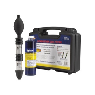

Unless the sensor is leaking this isn't going to fix it. The fan is already working so it's much more likely you have a small leak somewhere.
If you can't find any sign of leak then you might need to add some dye to the system and use a black light to see if you can find it.
It is possible you have the beginnings of a head gasket failure but saying he has to top it off each month seems to make it sound it's been going on for some time and usually they get worse as time goes by.
You can get a loaner tool from a parts store to try to test at the coolant expansion tank for hydrocarbons just to make sure it is/isn't the headgasket.

Yes and yes.
When our S70 head gasket went south it was loosing a little coolant and some had to be added monthly and just got worse.
http://atthetipwebs.com/technologyin...ead_gasket.htm
Then, when the rad fan wouldn't turn off after the drive, it was the ECT sensor that went bad.
