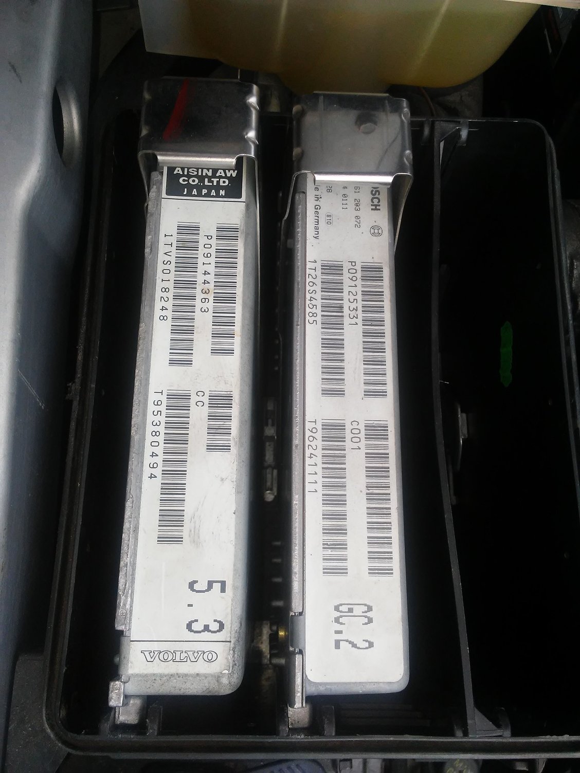

These are from the car the 96. This does not read.
These are from the donor car that the swap came from. The 97. This reads.
Thanks Tony, do you have a suggestion as to how I can do this? I am obviously in over my head.

The computer on the left is the transmission computer, thus the Aisin name on the box. Are you changing both computers or one?

Looks like the 97 has both different ECU and transmission control modules. than the 96. Might be stating the obvious, but........................

FYI - the poster and I had a conversation. I recommended that he use the computers from the 1996 model and be certain that the computer modules were firmly mounting in the pin pad. I suggested that he spray the area down with silicone spray so that the plastic components slide easier and make sure that both computers draw down on the pin pad connectors.
I believe that the spotty communication is due to improper pin contact.
Next, I advised him to recheck his cam and crank timing marks.
