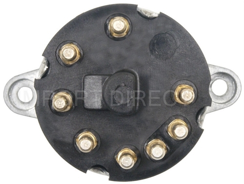

Old Sep 6, 2013 | 06:55 PM
You might also have an ignition switch problem. Sometimes when things don't work and you turn off and restart and they do it's the ignition switch that's starting to go. It has a lot of stuff running through it.
The relays are one layer down from the regular fuses.
Attached Thumbnails HELP with elec prob...-fuel-pump-relay-103.jpg   HELP with elec prob...-fuel-pump-relay-2.jpg   HELP with elec prob...-ign-switch-connectors.jpg
