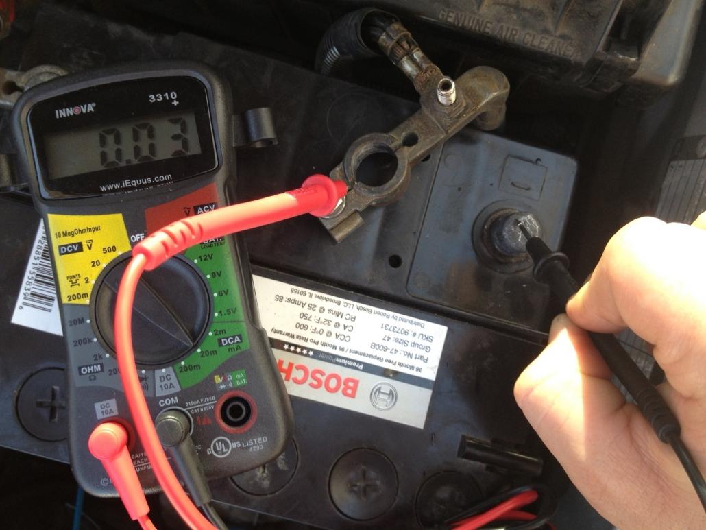

If your positive battery cable terminal has a nut on each side like mine does you also want to check that both sides are tight. Not tighten until something bends tight but securely tight. I didn't realize on mine one side tightens the cable to post connection and the second one tightens the feed wires to the fuse panel. I had never run across this type of set up before and after a batter install I tightened one nut down, it felt tight, didn't slip on the battery's post and I thought I was good. Dead car on the side of the road later and I found out by accident that I had loose wires on the other side of that terminal, it doesn't go all the way through
Attached Thumbnails Help please. N/a 97 Volvo 850 died on fwy-95-850-battery-positive-terminal-connection.jpg
