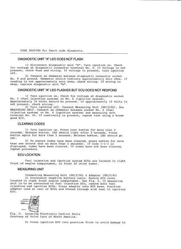

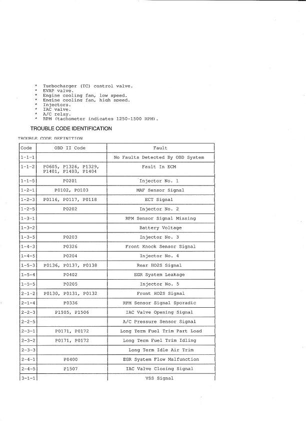

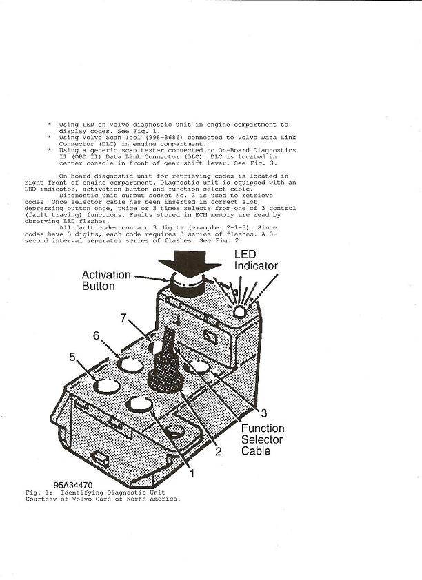

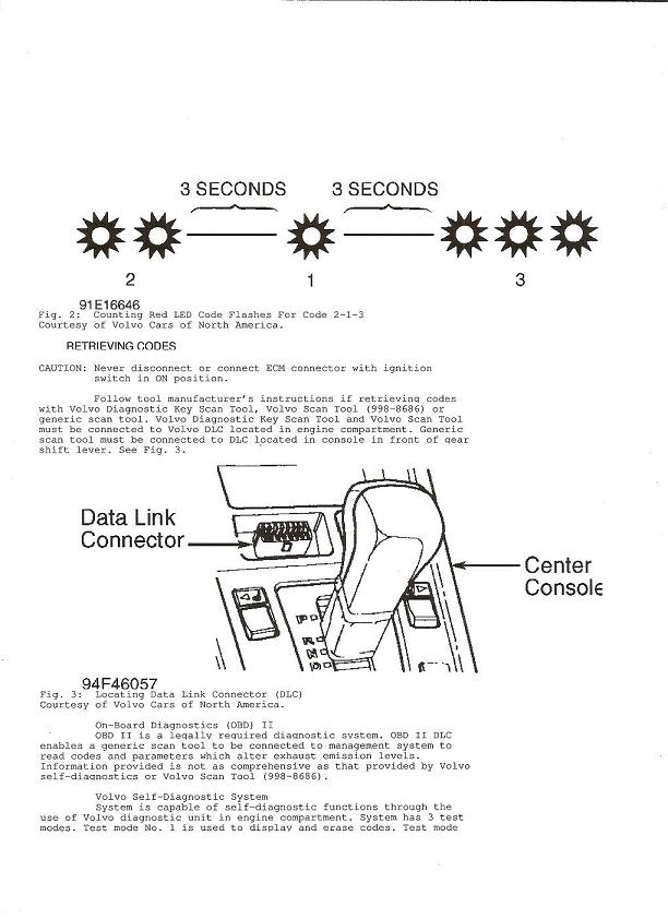

>changed the spark plugs, the distributor cap and the ignition coil....
These items hardly have anything to do with the described problems (but I assume they needed to be refreshed anyway).
I believe you're in EU, AU, NZ or Asia (the U.S models do not have the lambda light; it is Check Engine Light), correct? The lambda light is telling you that the on-board computer has stored a fault code in the electronic engine control. You need to retrieve the code(s) and post it(them) here so that we can better help you. You do not need any tools/testers to get the codes since your car is 1994 (1996 & later models require special tester). See attached for the procedure or wait until other members can describe it in the text.
I hope this gets you started.
(Please be easy on me, I am a male AND black-haired Asian)
JPN
Attached Thumbnails Hi, I am new and have a problem...-850-turbo-detailed-obd-i-2-.jpg   Hi, I am new and have a problem...-850-turbo-detailed-obd-i-3-.jpg   Hi, I am new and have a problem...-850-turbo-detailed-obd-i-4-.jpg   Hi, I am new and have a problem...-850-turbo-detailed-obd-i-5-.jpg   Hi, I am new and have a problem...-850-turbo-detailed-obd-i-6-.jpg

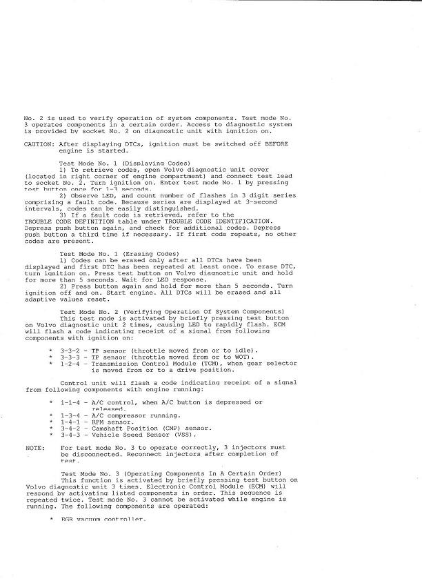

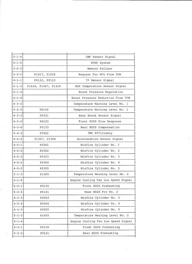

2nd reply.
If they seem overwhelming, have someone else work with you or let us know and we will walk you through with the procedure.
JPN
Attached Thumbnails Hi, I am new and have a problem...-850-turbo-detailed-obd-i-7-.jpg   Hi, I am new and have a problem...-850-code-1.jpg   Hi, I am new and have a problem...-850-code-2.jpg   Hi, I am new and have a problem...-850-code-3.jpg   Hi, I am new and have a problem...-850-code-4.jpg

The model is amanual with a 2.0l engine. I live in the UK, so yes, it is an european model. I actual thought the Lambda sign shows a broken cat converter. You learn something new every day.
So when I check for the codes, how do I do that, if I don't need an extra tool. I read the attachments, but they all seem to imply you need some "scanning" tool.

The tool shown in the posts above is actually built-in on your car under the hood. If you print these instructions and then go under the hood of the car, You should be able to get to read the codes and clear them from there. The procedure looks very scary at the first look but is really simple once you get to know it.
