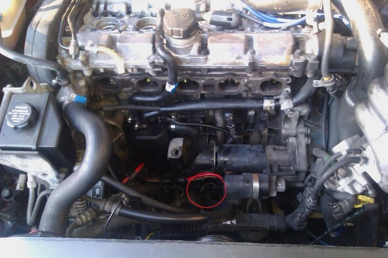

Old Mar 4, 2012 | 12:31 AM
You don't have to take the intake off to get to the sender. You should be able to get to it from underneath. I think it's a 24mm deep well to take it out.
First photo the sender is circled, it's right behind the starter. Second one is of the sender close up.
Attached Thumbnails High mileage oil-oil-pressure-sender-location.jpg   High mileage oil-oil-pressure-sender-engine.jpg
