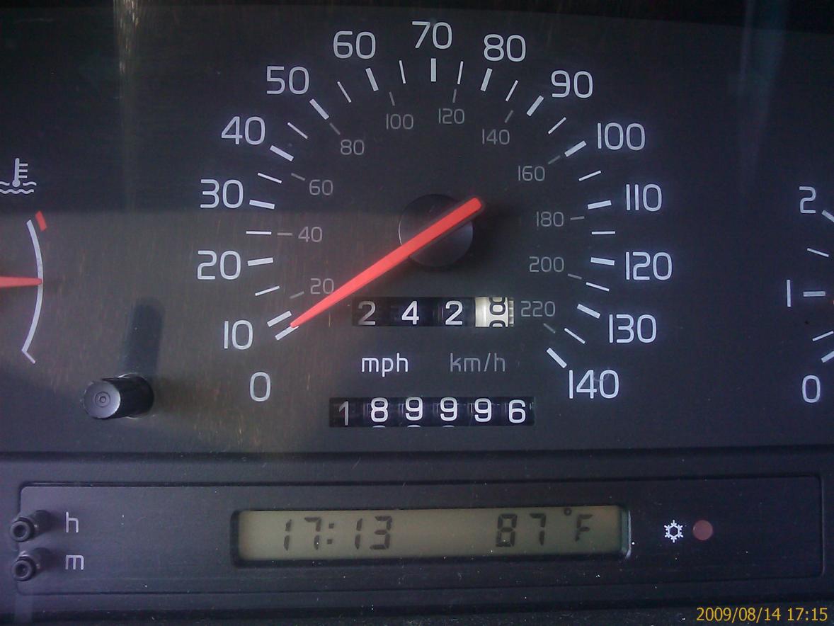

I have seen pics of a LCD display that only had the time and not the temp, so they do exist. Not sure if they were part of a bare-bones option package or what...
Here's a picture of the time & temp display - note the width of the LCD panel is about 2.5 inches (give or take). The "time only" display is only an inch wide (or there abouts) and only has enough room for the clock.
The Trip Computer option has a display that is about an additional inch wider than the Time & Temp display.

Wow! I learn something new every day. I didn't realize that the lcd display was actually a different size. Here is one from my T-5R. I put a little yellow circle on the control ****.
You can not just drop it in with the wire that connects it to the display switch. There is actually another cable that connects the lcd display to another part of the i/p or somewhere. I have not pulled my dash yet so I'm not sure where, but I did get a display for some reason that I sold to a guy that had a problem getting it to work because of this missing cable.
As for the temp gauge, there is a sensor that is wired to the front spoiler area. I can post a picture if you need me to.

Where do you guys get these Outside Temp in the 70s or 80s?
BTW, that's a VDO Instrument Panel.
