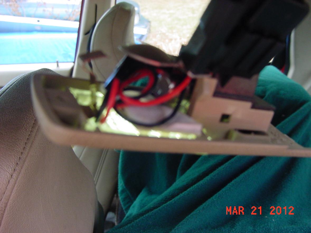

I put festoon LEDs in both my overhead and floor courtesy lights. It's just wonderful.
They were dirt cheap, under $2 each. I have a wagon and the rear ceiling light is a festoon style so it was just a swap and really a difference, big difference.
The overhead in the front I soldered leads to the bulbs (tricky to keep them from coming apart) and then connected to the panel.
Over the rear door I bought the one's with the B9 style adapter as by then I liked the way it looked and I knew how it would work and it was worth the $5 ea price to have a smaller board of LEDs and direct plug in, no soldering.
That's why the difference in the look of the front center LED's to the one over the rear door.
Since it's a flat panel in either case all the light goes down so it works well. The courtesy lights in the lower edge of the dash by the doors don't fit flat so they were each angled in so they pointed at the door at an angle and they do actually work for "puddle" lights too. But I read about someone using a flat led and two sided tape and wiring it into the circuit for the red light in the door jam you see when the door opens. I might try that one myself.
Attached Thumbnails  LED lights!-interior-courtesy-lights-front-center-back-leds.jpg    LED lights!-interior-courtesy-lights-front-center-front.jpg    LED lights!-interior-courtesy-lights-above-rear-doors-2.jpg    LED lights!-dsc01193.jpg    LED lights!-dsc01195.jpg
