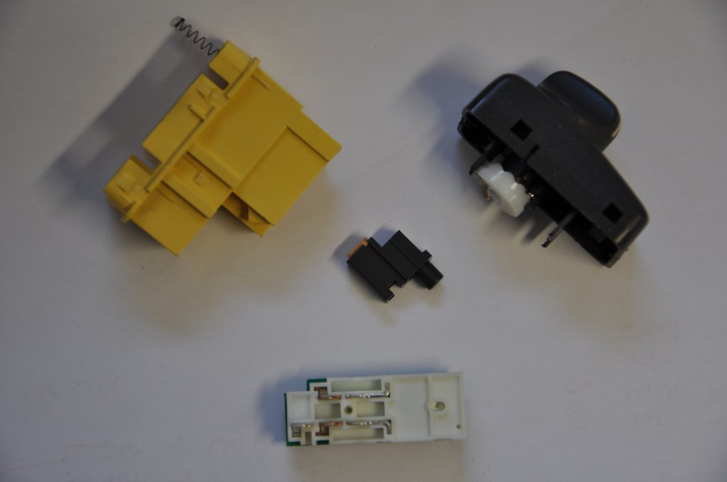

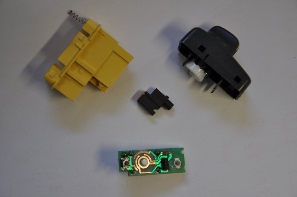

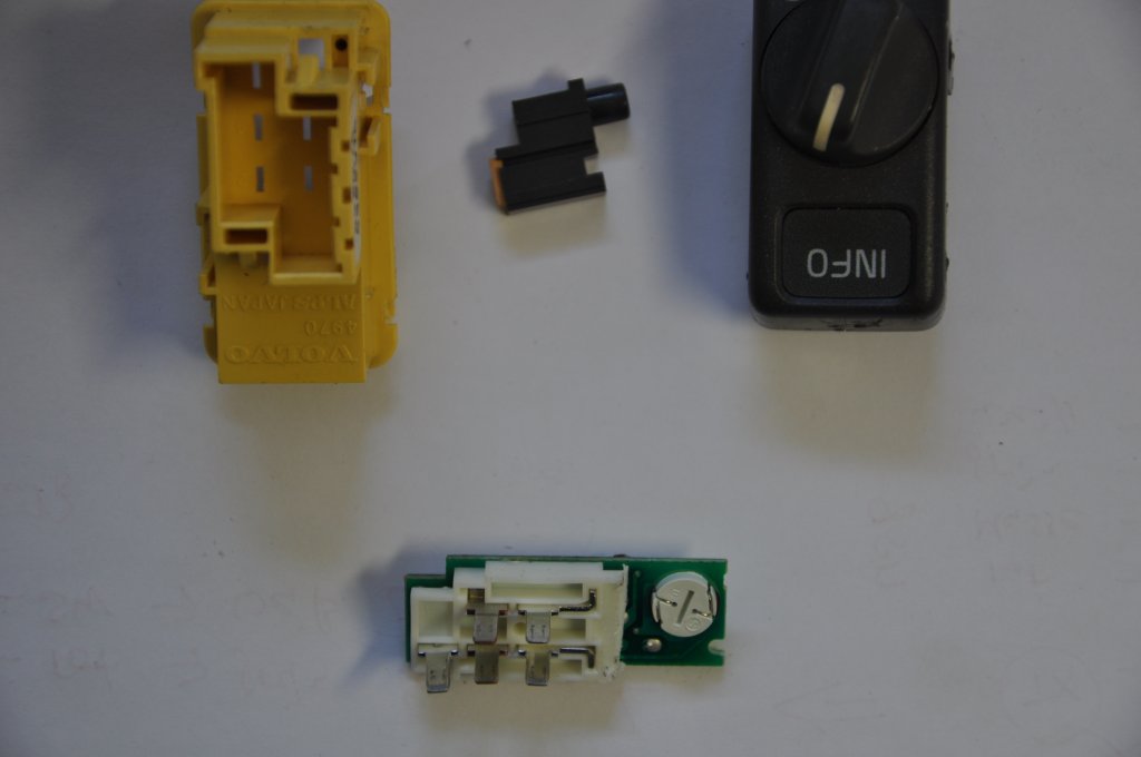

Concerning the Info switch:
You need to solder (if you do not want to go the dremel route). The white plate with the contacts is in the way so if you desolder the contacts you can change the bulb. You could of course cut out the part which covers the back of the bulb...
The bulb is behind the connector plate and it has a smaller bulb socket, same bulb as the rest of the switches.
Be carefull with the small spring and do not bend the contacts from the switch itself.
